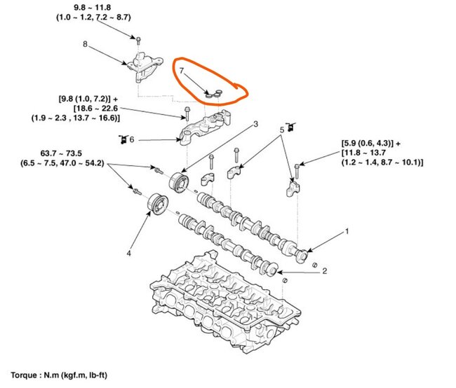

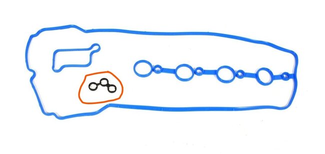

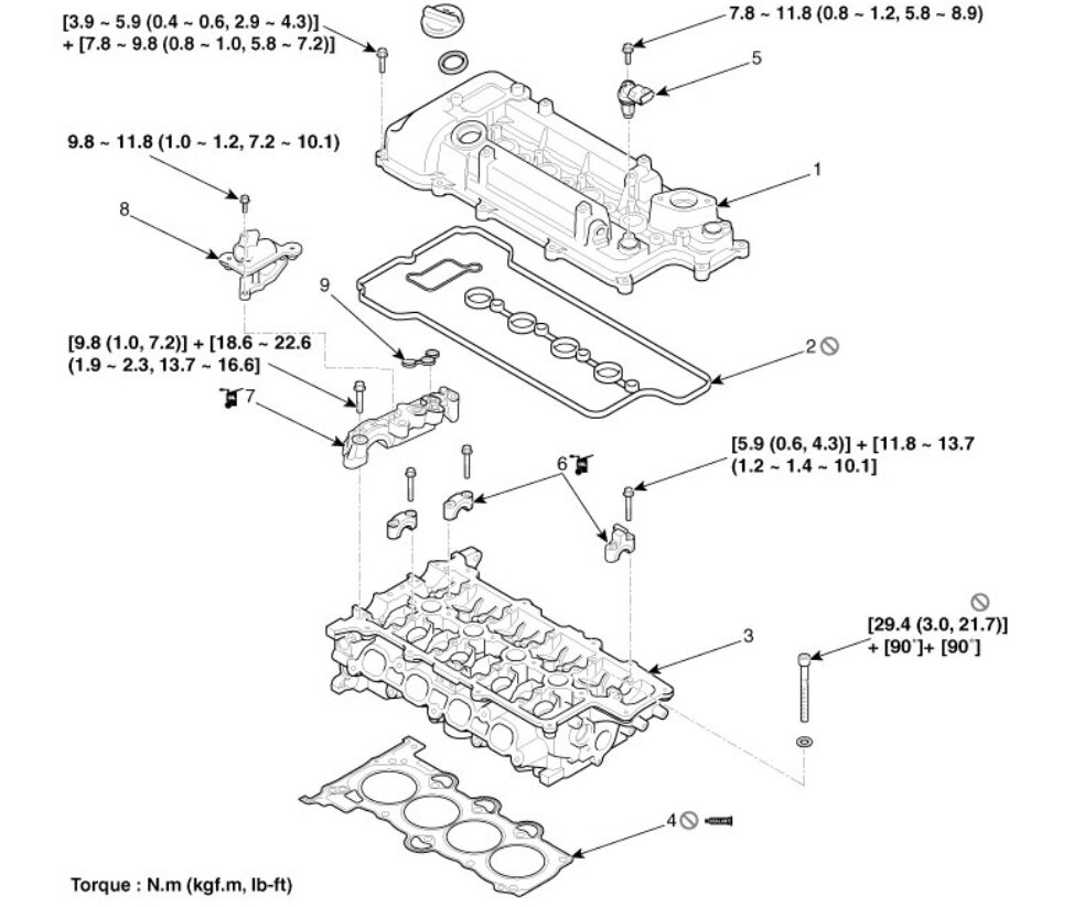

I just bought this car, and I am trying to do it myself because I like working on my cars. I noticed it was leaking oil, so I changed the gasket and noticed oil in spark plugs. Ready for install don’t know the torque spec or pattern?? Someone help please and thank you. Also, I bought kit from rock auto. There is a gasket with 3 little circles I have no idea where it goes!?

Sometimes they give you extra gaskets for the camshaft position sensor and the oil cap or accessories mounted to the valve cover. Here is a generic guide to help you step by step with instructions in the diagrams below to show you how on your car:
https://www.2carpros.com/articles/replace-valve-cover-gasket
Check out the images (below). Please upload pictures or videos in your response of any problems so we can see what to help you with.

The 3-ring gasket is for the oil control valve adapter. Ticking could be valvetrain or lower engine, would need to hear it to determine which. Hard to say what caused it to shut off. When you try to start it what does it do, just crank over and not fire? If yes, try opening the air filter housing and spraying some carb cleaner into the intake and then see if it tries to run. If it does, then it's likely a fuel issue. If there is no change then it's probably ignition.
