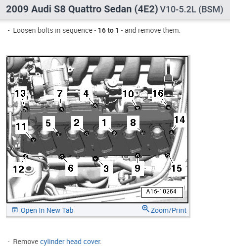

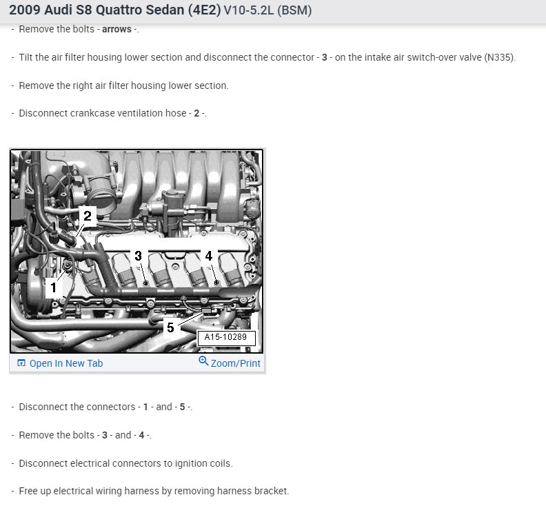

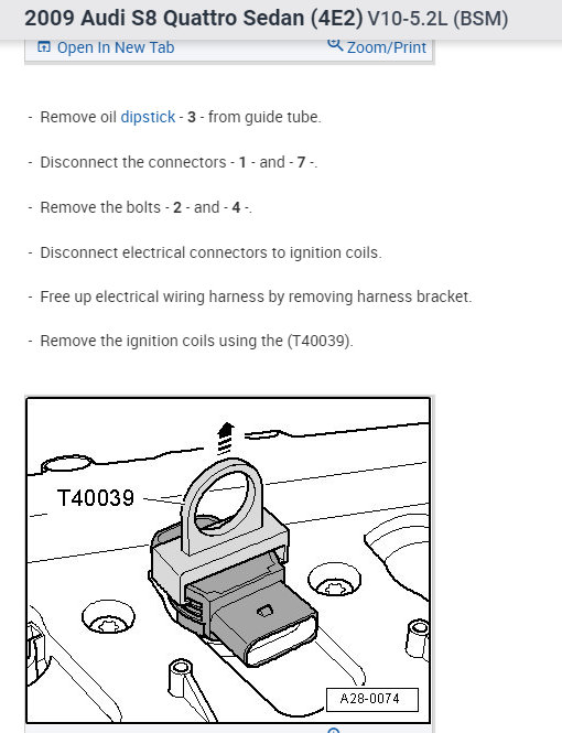

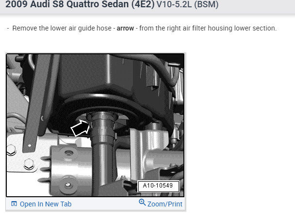

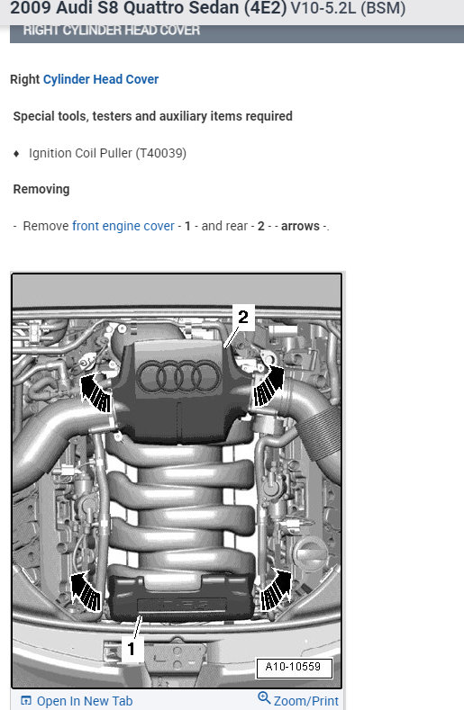

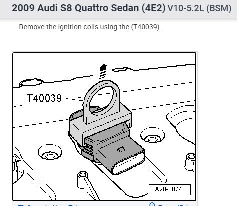

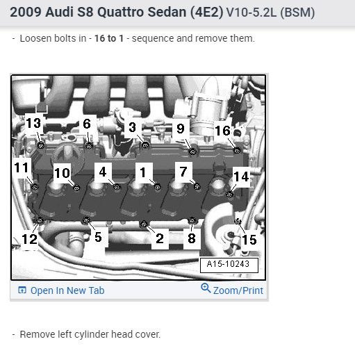

Just saw some smoke and an oil smell, pretty sure it's from the valve cover gasket on passenger side. I need instructions on how to replace that side if you have it.

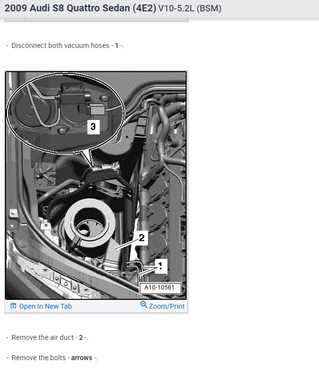

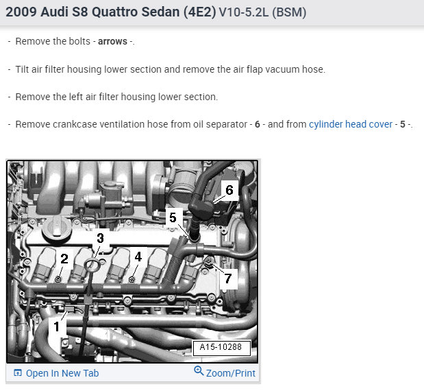

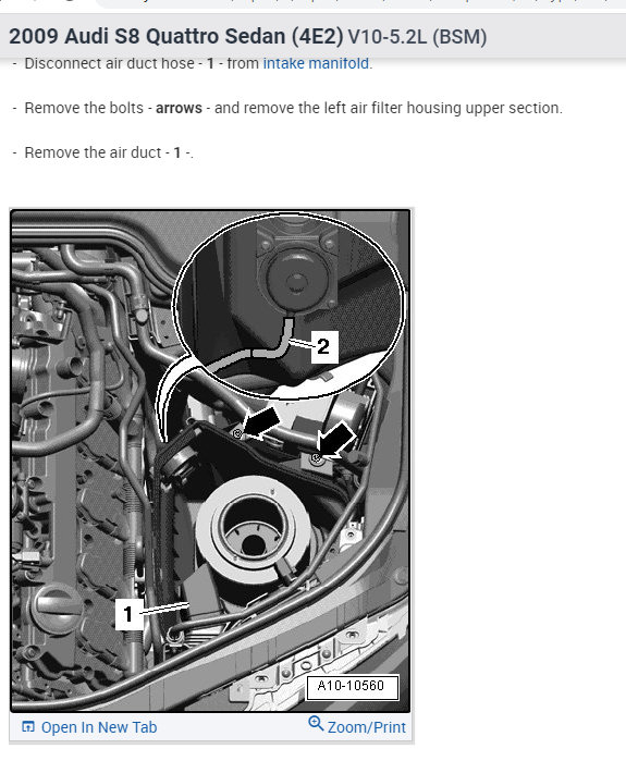

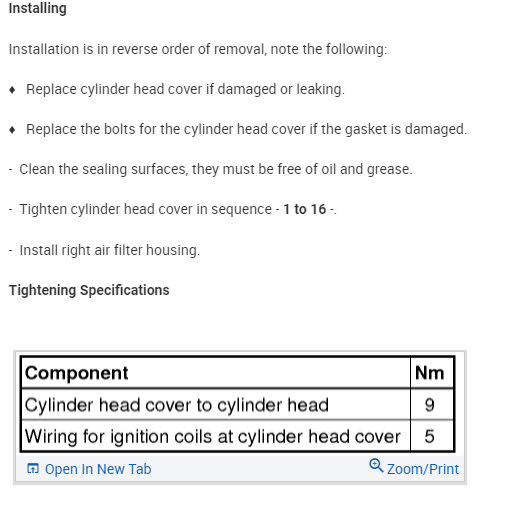

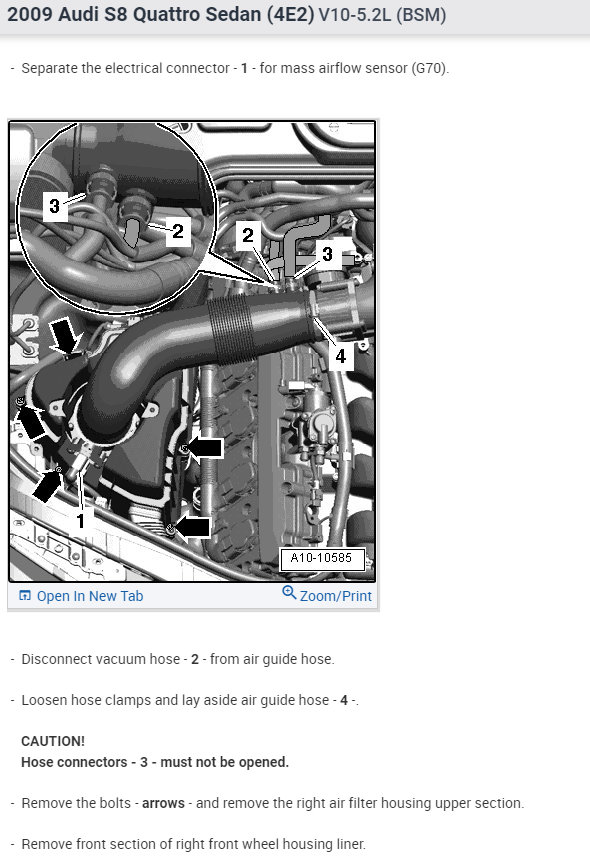

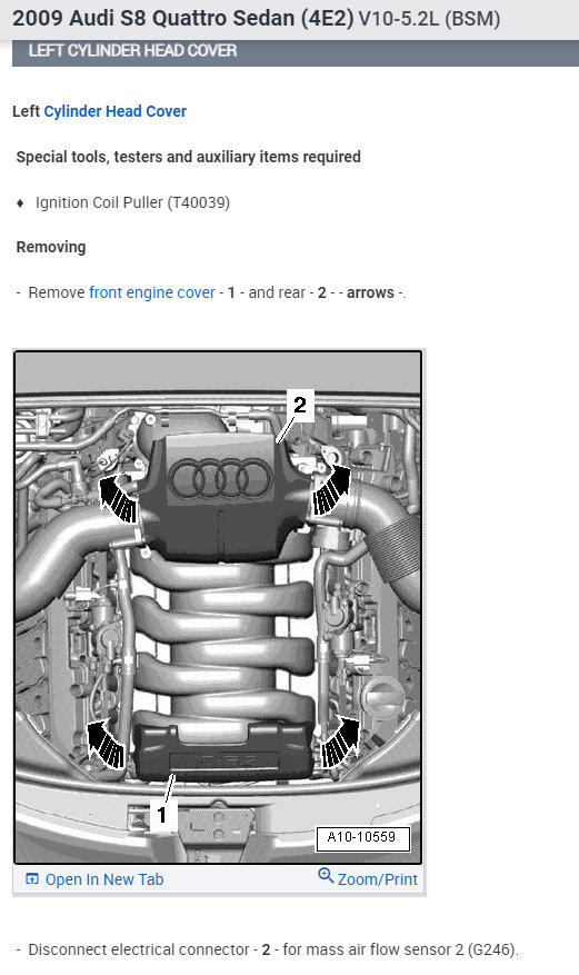

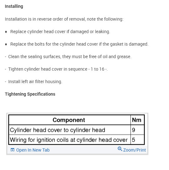

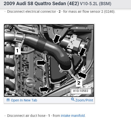

See attached for the valve cover removal and installation procedures.
https://www.2carpros.com/articles/replace-valve-cover-gasket
