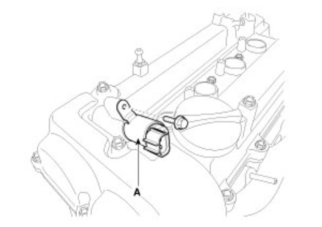

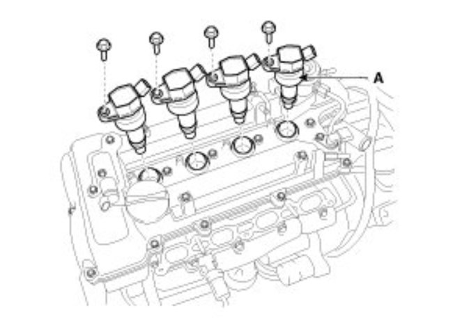

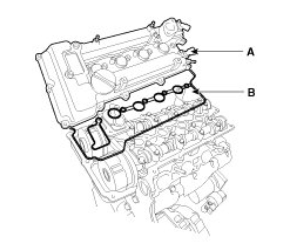

How can I replace gasket or make one?
Monday, December 13th, 2021 AT 9:09 PM
3 Replies
MECHANIC
52,797 POSTS
Good morning,
I attached the procedure for you to replace the gasket.
https://www.2carpros.com/articles/replace-valve-cover-gasket
Tighten the bolts to 120 inch-pounds to secure it.
Do not make one, you need the pre-made gasket for this repair.
