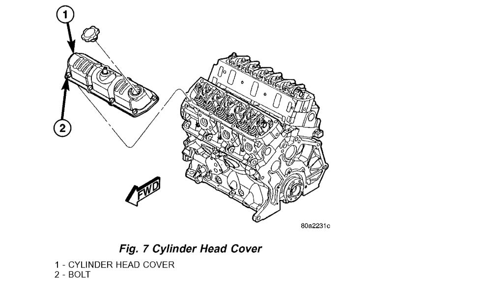

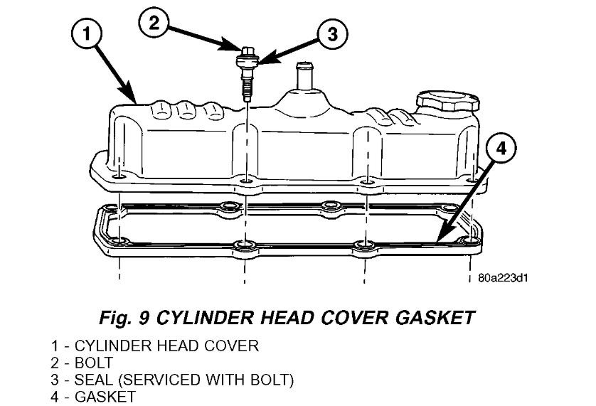

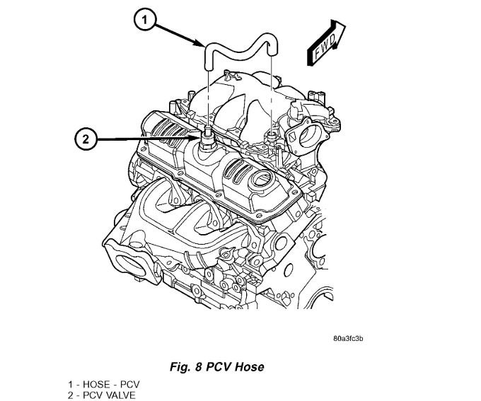

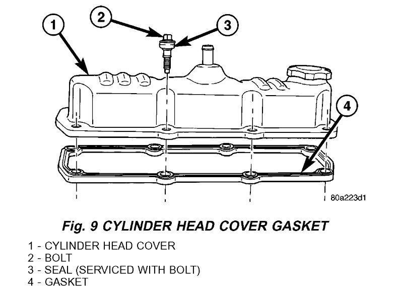

I have oil leaks from my valve cover. Is the valve cover gasket difficult to replace on this car? It looks like the valve cover in the back is hard to get to.

The gaskets are tight to access but can be done as a project. I attached the procedures below with some pictures.
CYLINDER HEAD COVER RIGHT
REMOVAL
1. Disconnect negative cable from battery.
2. Remove the wiper module. (Refer to - ELECTRICAL/WIPERS/WASHERS/WIPER MODULE REMOVAL)
3. Disconnect spark plug wires from plugs.
4. Disconnect PCV hose from cylinder head cover (Fig. 8).
5. Remove cylinder head cover bolts.
6. Remove cylinder head cover and gasket (Fig. 7).

1. Clean cylinder head and cover mating surfaces. Inspect cylinder head cover surface for flatness. Replace gasket as necessary.
2. Inspect seal on the cover bolt for wear or damage (Fig. 9). Replace bolt assembly as necessary.
NOTE: The cylinder head cover bolts contain a torque limiter sleeve and a seal (Fig. 9). The seal and torque sleeve is replaced with the bolt.
3. Assemble gasket to cylinder cover by inserting the bolt assemblies through each bolt hole on the cover and gasket (Fig. 9).
4. Install cylinder head cover and bolts (Fig. 10).
5. Tighten cylinder head cover bolts to 12 Nm (105 inch lbs.) (Fig. 10).
2. Assemble gasket to cylinder cover by inserting the fasteners through each bolt hole on cover and gasket (Fig. 9).
3. Install the cylinder head cover and bolts (Fig. 10).
4. Tighten cylinder head cover bolts to 12 Nm (105 inch lbs.) (Fig. 10).
