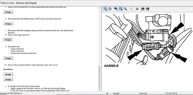

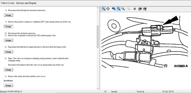

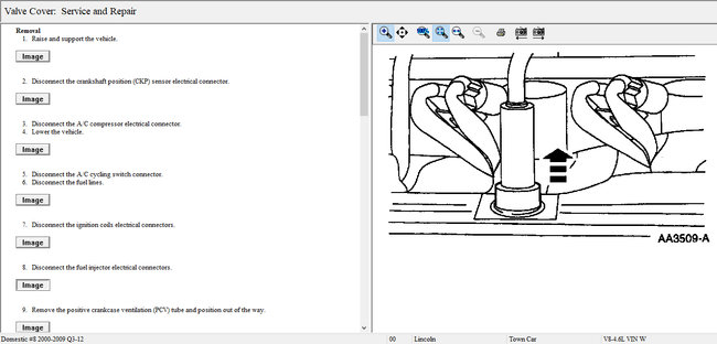

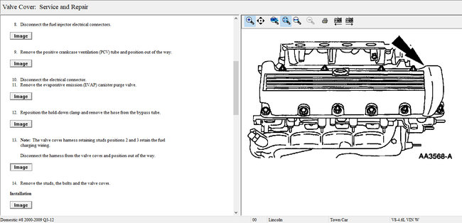

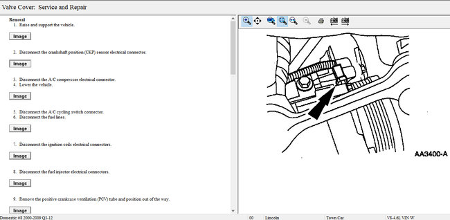

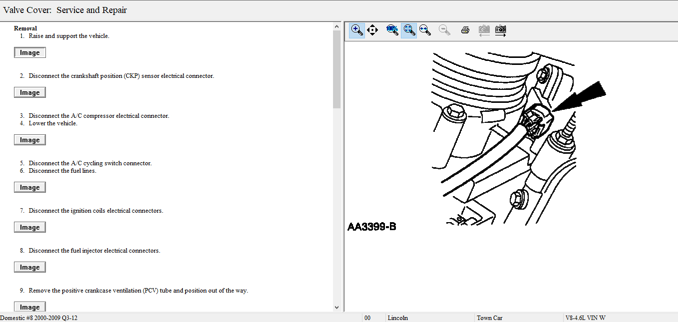

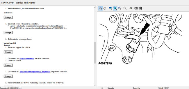

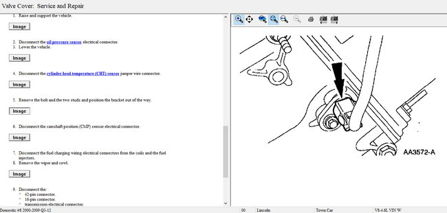

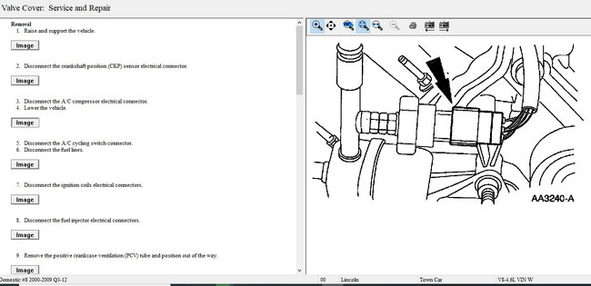

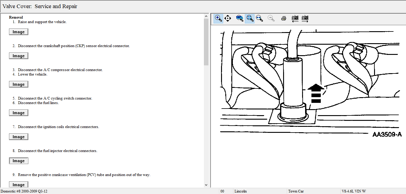

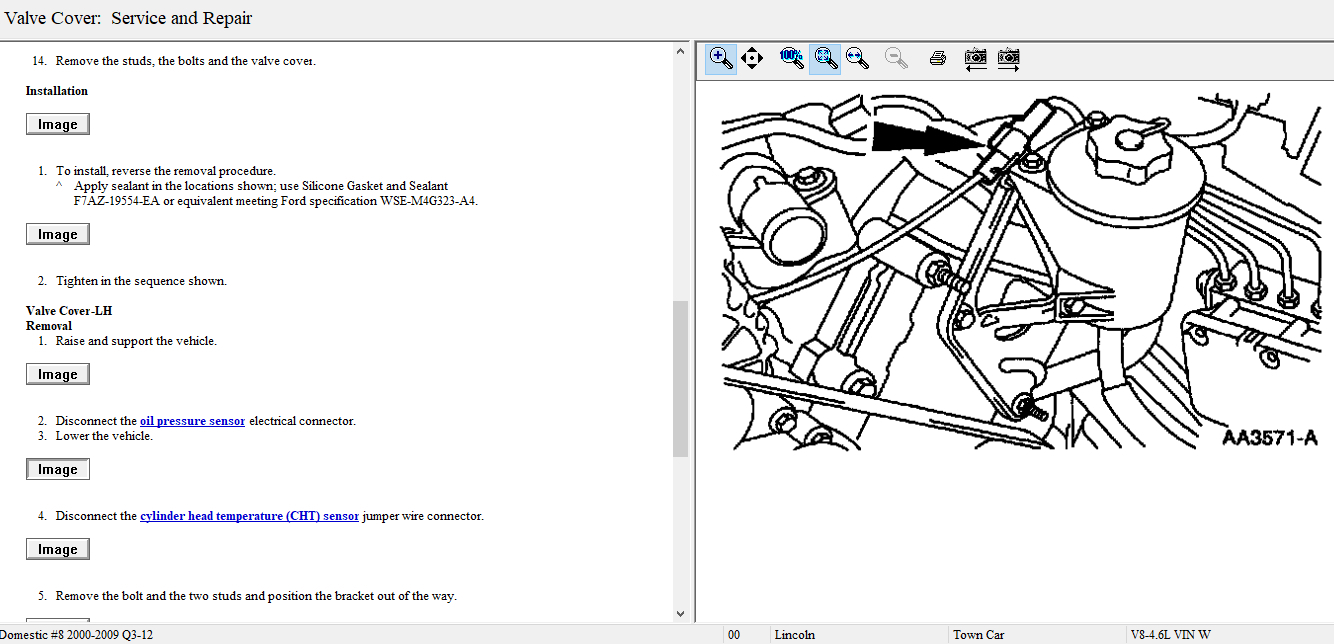

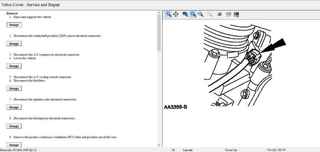

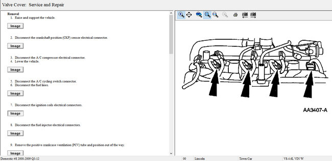

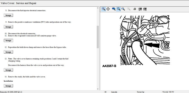

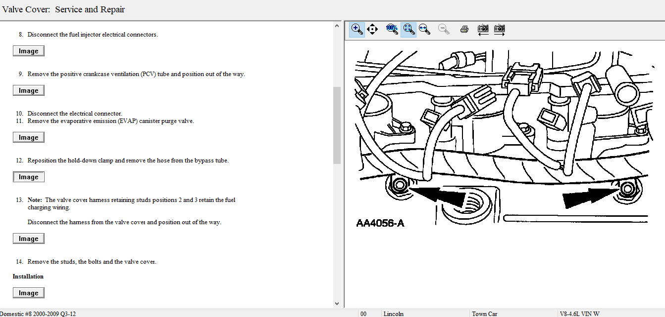

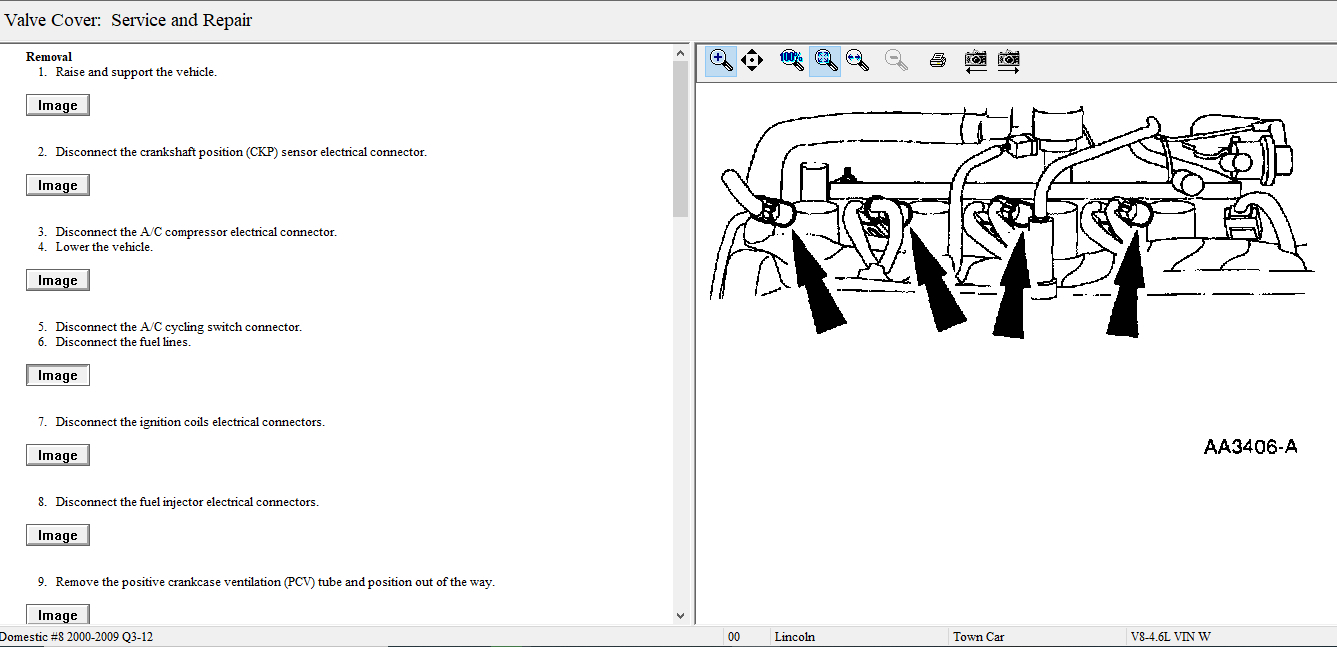

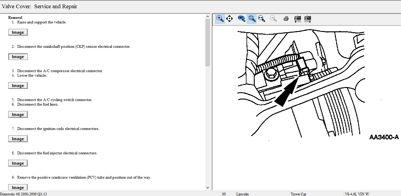

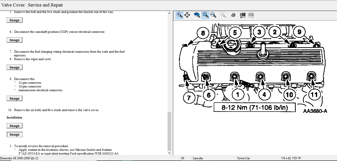

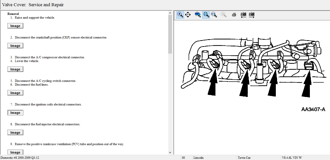

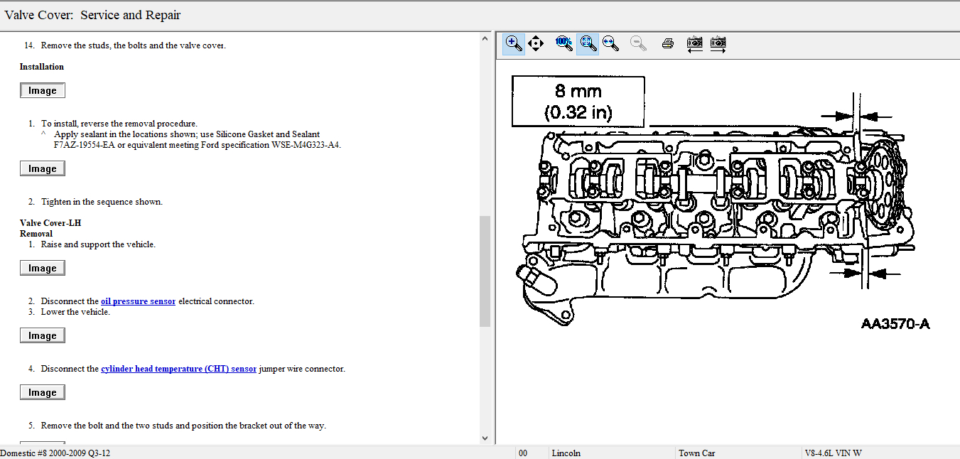

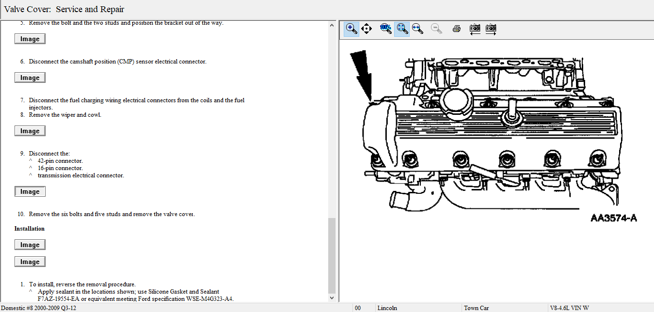

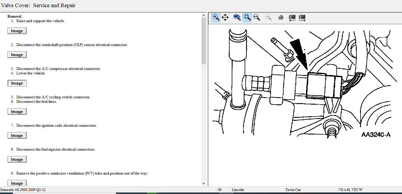

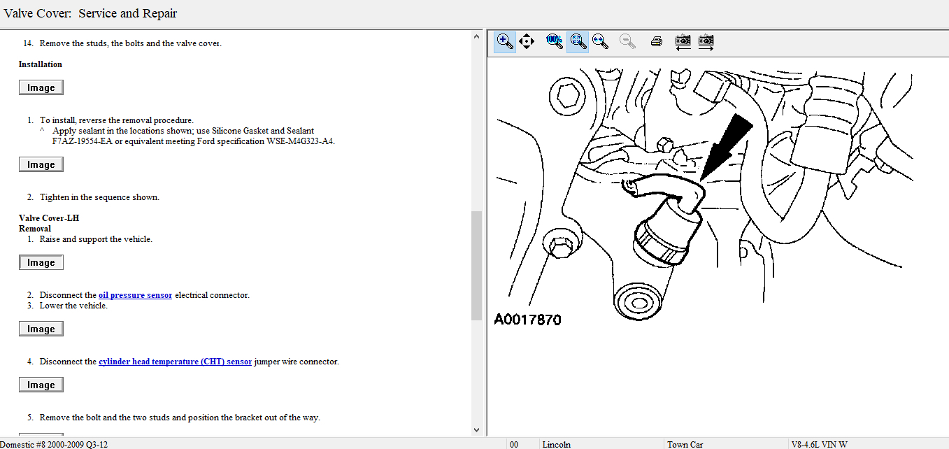

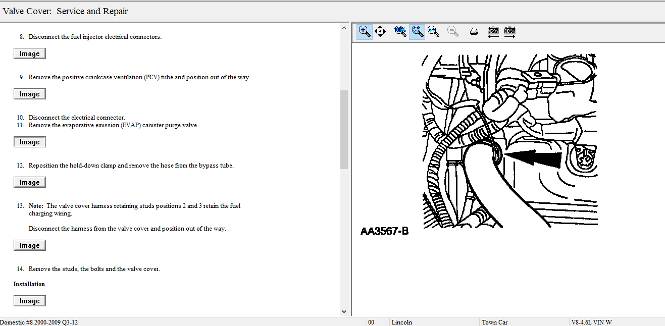

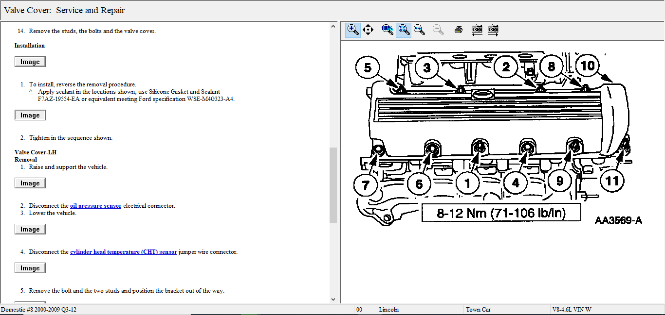

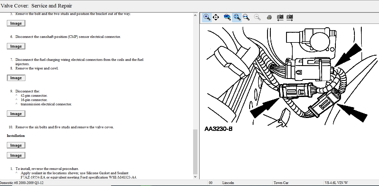

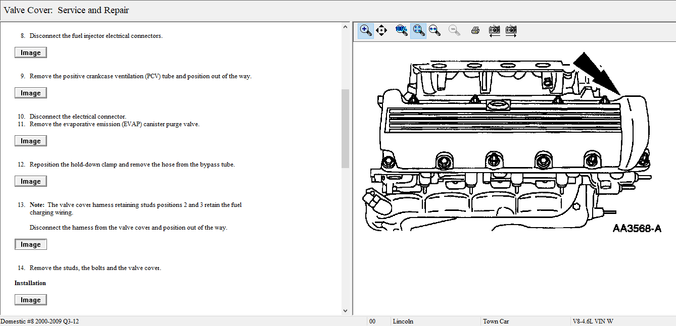

What is the procedure for changing the valve cover gasket?
Monday, February 8th, 2021 AT 10:29 AM
SEVAG P
MECHANIC
405 POSTS
Hello.
check our link below how to remove and reinstall valve covers.
https://www.2carpros.com/articles/replace-valve-cover-gasket

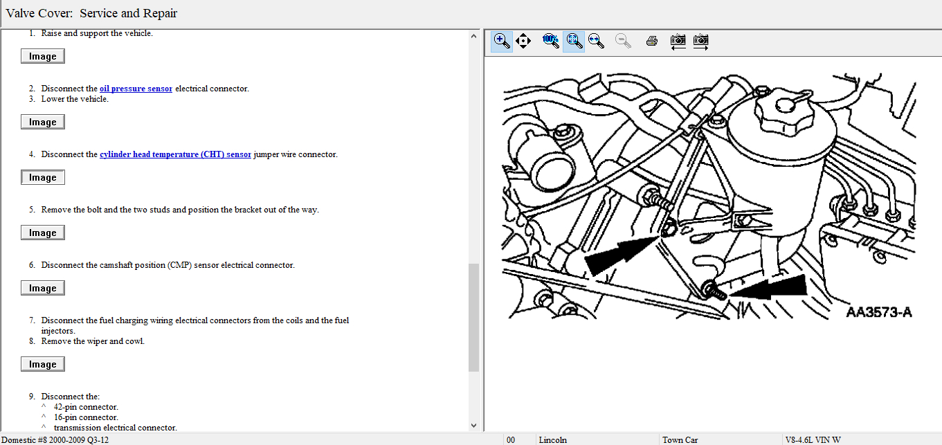

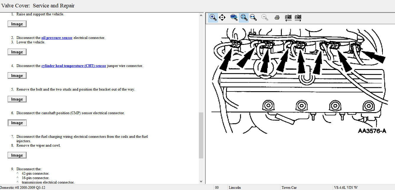

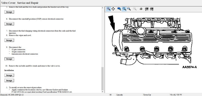

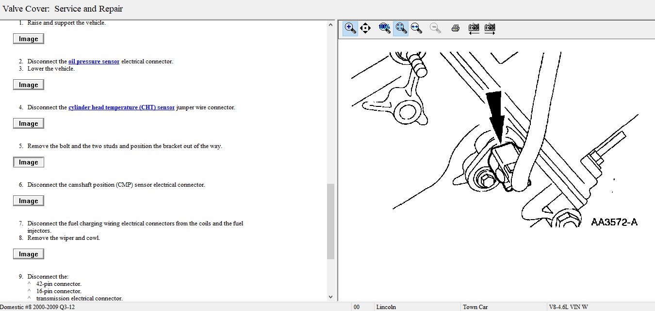

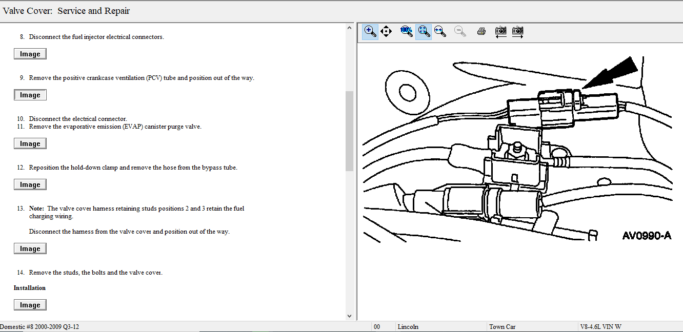

Check the diagrams below procedure step by step specific to your engine valve cover remove and reinstall.
let us know if you need more help.
thank you.
