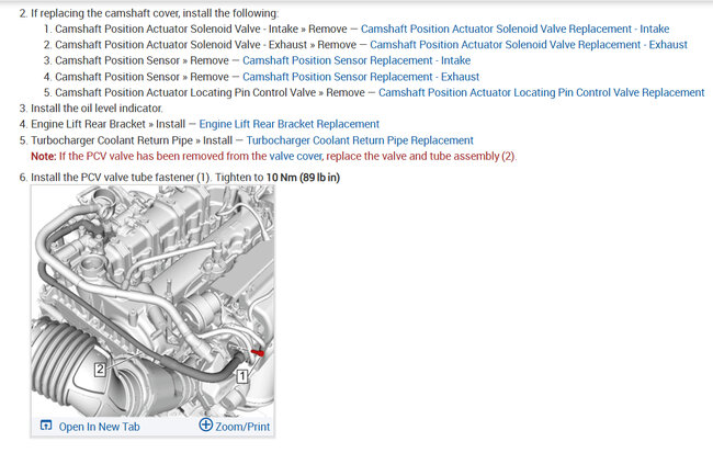

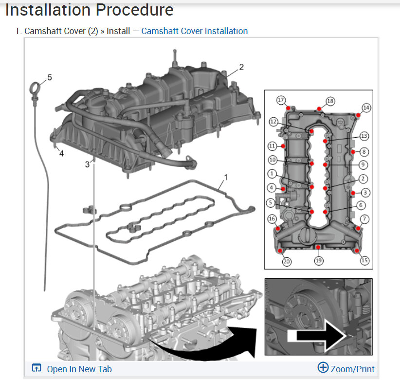

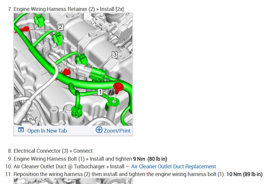

Can I get the Valve cover bolts torque spec?
2019 CHEVROLET EQUINOX
136,000 MILES • 1.5L • 4 CYL • TURBO • 2WD • AUTOMATIC
RICKY001
MEMBER
1 POST
Valve cover torque specs and sequence.
Jan 31, 2025 at 2:47 PM
Experienced Mechanic
55,553 POSTS
Sure, here are the instructions and the torque spec and sequence on how to tighten the valve cover back down. Check out the images (below). Let us know if you need anything else.
