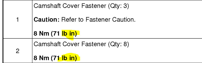

I am replacing the valve cover gasket?
Sep 7, 2024 at 2:39 AM
  • 110,244 POSTS
For some reason, the manual doesn't provide a sequence. It does indicate 71-inch pounds. (See pic below)
What I would recommend is to install all of the bolts hand tight first. Then, starting in the center and working in a crisscross pattern, tighten them to 35-inch pounds and then repeat the same thing to reach 71-inch pounds.
Note this is inch pounds and not foot pounds. Don't overtighten the cover. It can break.
Let me know if this helps.
See pic below.

Thanks for your quick response. I will definitely follow your recommendation in terms of sequence and torque specs when I do the job tomorrow and hopefully no more leaks. I will keep you posted.
Sep 7, 2024 at 12:05 PM
ANDTEMIN
Replaced the gasket and torqued it to specs provided with the sequence provided and no issues. No leaks

Thanks for the update. I'm glad you got it taken care of. Drive it for a few days and recheck the torque just to make sure nothing has changed.
Take care and feel free to come back anytime in the future.
