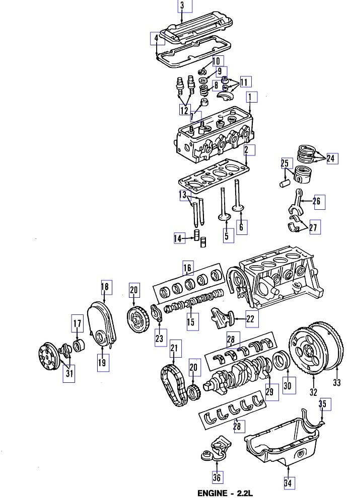

Do you have carried the back cover bolts for the vehicle listed above? If not, would you know the size of them and the diameter?

I did look up the exploded view of your engine, and, as expected, they didn't show the bolt sizes. In fact, they didn't even show the bolts. I found another source that says your bolts are 1/4-20, meaning 1/4" by 20 threads per inch, but it didn't give a length. I'm a little wary because by '94, GM had been using metric fasteners for a long time. What also happened with many manufacturers is they held over the standard fastener sizes to the next year(s), and only switched to a metric size when a new part was developed. A good example could be when GM switched to a new generator design in '87, it would have been built with all metric fasteners, while the carburetor could have been the same as used in previous years, so it still had standard fasteners. We fought with a mix of standard and metric fasteners on one vehicle for many years.
Let me know if that helps and you solve this.
