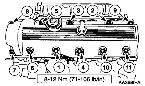

Been having misfires and been changing the coils. changed out all the sparks last year. when i pull out the coils there is some fluid on it. i talked to a local mechanic and he was saying it could be because of the valve cover gasket leaking and causing them to short out or whatever. i would like another opinion. is he wrong and what would be the cause of it?
Nov 16, 2017 at 8:23 AM
STEVE W.
  • 15,418 POSTS
Oil around the coils can short them out and cause misfires, actually pretty common reason on a variety of cars and trucks. Gasket and o-ring replacement should stop any leaks and prevent misfires from oil.
Nov 16, 2017 at 9:03 AM
CHEVY__88
  • 104 POSTS

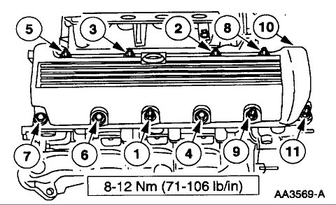

Any specific order to tighten the bolts ?
Nov 16, 2017 at 9:08 AM
STEVE W.
  • 15,418 POSTS
These are the sequences for the left and right sides. Do not forget the small beads of sealant at the timing cover to head joints.
