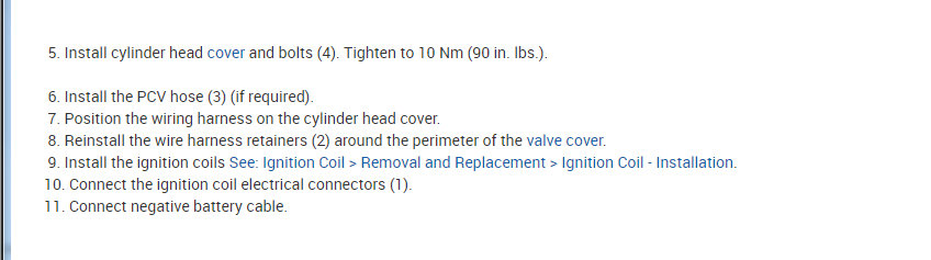

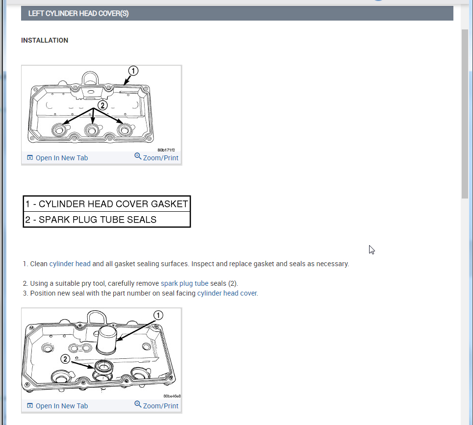

Oil leaking around the bolt on valve cover
2009 CHRYSLER ROYAL
140,000 MILES
STARLORD1976
  • 173 POSTS
What can I do to fix this whiteout changing valve cover seal?
Apr 17, 2021 at 12:12 AM

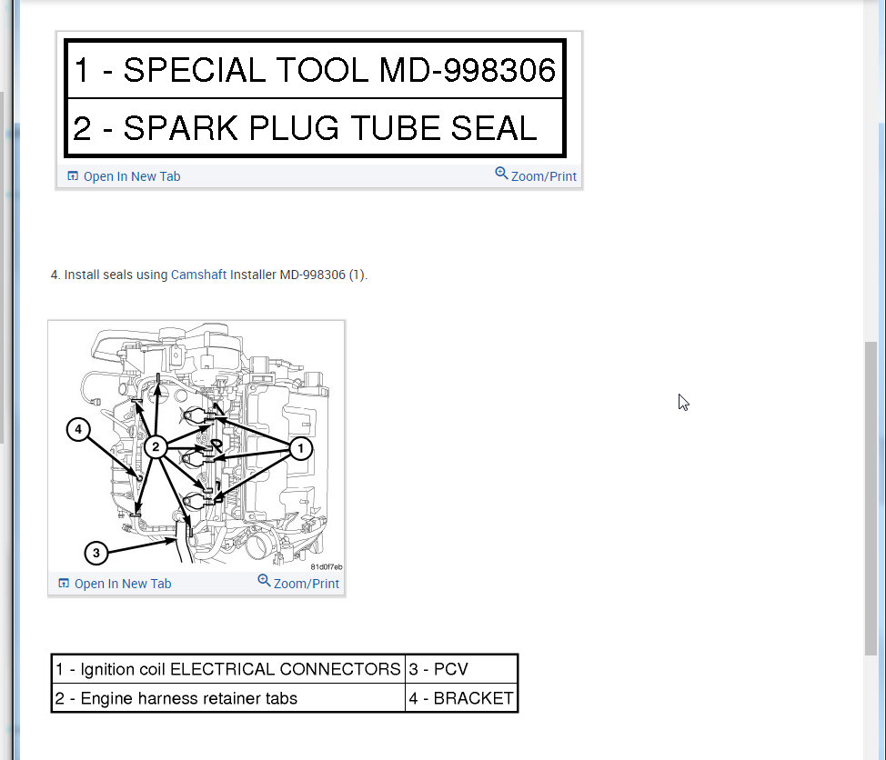

Unfortunately changing the seal is the only way to fix these. Some people will say you can put silicone on it but that will not last long if at all.
I am attaching the process below on how to replace this however, you noted that this was a Chrysler Royal but that vehicle was not produced since the 1950's so I assume you meant a Sebring.
If not, let me know if I am missing something. Thanks.
