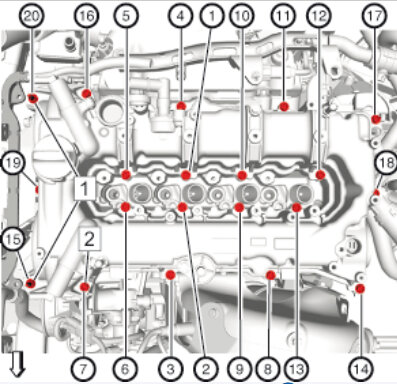

I have the next gen Cruze with aluminum valve cover. What are the torque specs for this model and sequence?
Also what is the torque for the vacuum pump?

Please start a new thread for the vacuum pump torque specs, the specs for the valve cover is:
15 nm or 11 lb ft.
Let us know if you need anything else.

Okay. Do you know the sequence for the valve cover bolts?
Sep 19, 2025 at 2:26 AM
  • 55,746 POSTS
Yep, here it is. Check out the images (below). Let us know how it goes.
