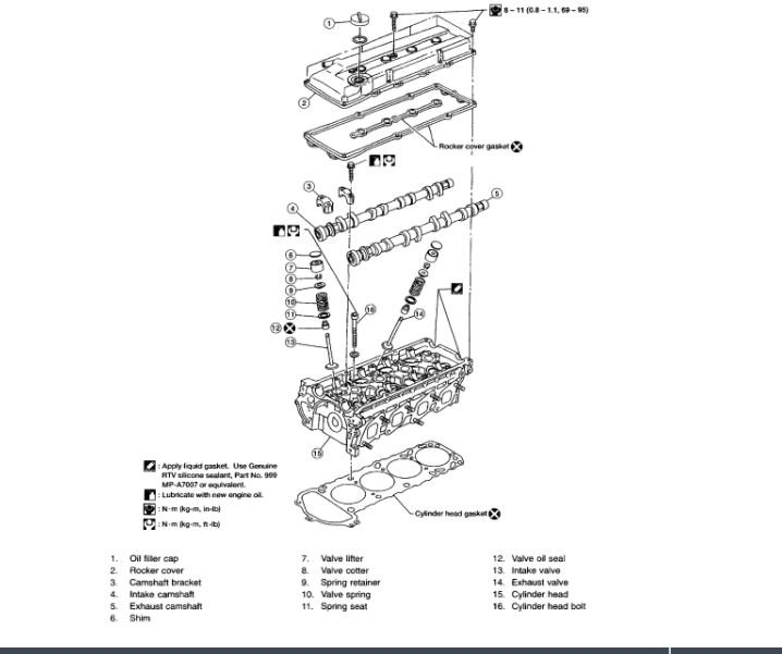

installed a new head on my truck with dual overhead cams. ran great for 2 months then shut down. I pulled the front timing cover and the new chain had broke. does this dual overhead cam engine have clearance or the valves to be safe or did I lose this head as well? need options before trying to replace a new chain. I did turn the crank by hand and met no resistance.
Feb 24, 2021 at 11:22 PM
Good morning,
You have valve damage as it is an interference engine.
https://www.2carpros.com/articles/how-a-cylinder-head-works
The heads will have to be removed and inspected. It may be okay to just receive new valves.

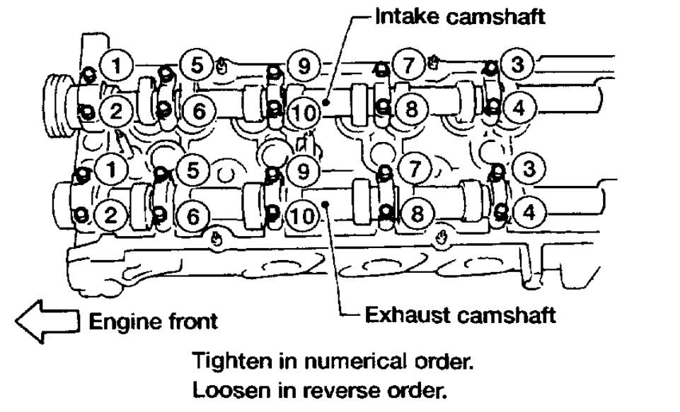

- When installing camshafts, chain tensioners, oil seals, or other sliding parts, lubricate contacting surfaces with new engine oil.
- Apply new engine oil to threads and seat surfaces when installing cylinder head, camshaft sprocket, crankshaft pulley, and camshaft bracket.
- Attach tags to valve lifters so as not to mix them up.
- Before removing camshaft and idler sprockets, apply paint marks to them for retiming.
1) Remove upper timing chain and idler sprocket.
- Refer to "UPPER TIMING CHAIN" and "IDLER SPROCKET", under Timing Components; Timing Chain; Service and Repair.
- For retiming during cylinder head removal/Installation, apply paint marks to camshaft sprockets, upper timing chain, lower timing chain, and idler sprocket.
2) Remove camshaft brackets and camshafts.
- Mark these parts' original positions for reassembly.

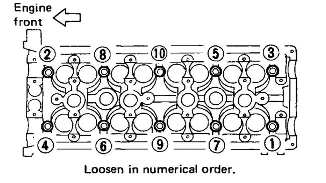

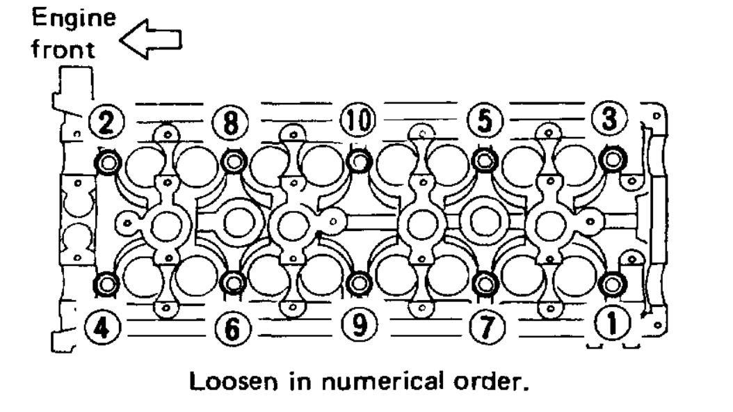

3) Remove cylinder head bolts in numerical order.
- Removing bolts in incorrect order could result in a warped or cracked cylinder head.
- Loosen cylinder head bolts in two or three steps.
4) Remove cylinder head and cylinder head gasket.
