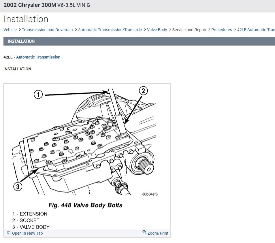

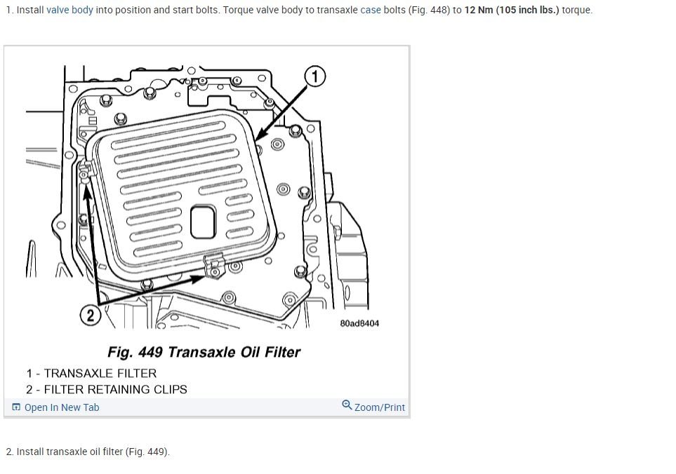

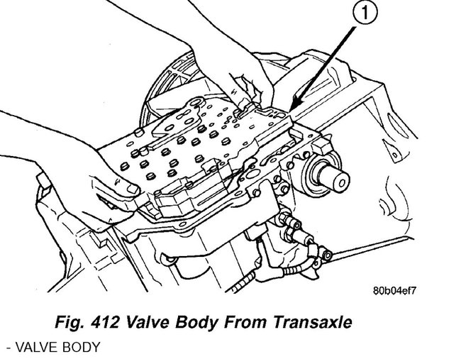

I'm having an issue figuring out which holes are mounting holes for the valve body. Does anyone have an accurate description of where and how many bolts mount the valve body? Any help would be greatly appreciated.thank you

Are you replacing the valve body on to the transmission? If memory serves me the bolts that connect the V/B to the transmission are actual hex head bolts. The Phillips head bolts secure the separator plate to the valve body.
I was not able to find a picture that shows the exact number and placement of bolts, but these should help you .

Thank you for the reply, but I actually got it figured out on my own. Turns out I ended up dropping 2 bolts in my drain pan and couldn't find them for a bit, lol.
