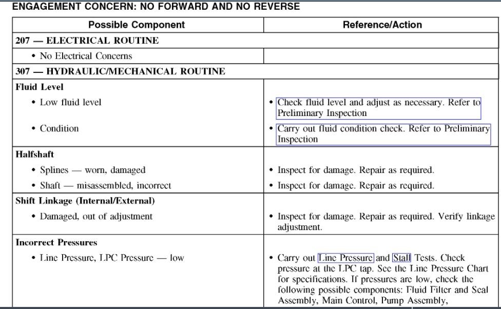

Valve body, car will not move in any gear
2007 FORD EDGE
180,000 MILES • 3.5L • V6 • 4WD • AUTOMATIC
TOMMY1969
Changed TSS and OSS sensors and car won't move in any gear. Will missing check balls cause this problem?
Feb 13, 2021 at 10:55 PM
Good morning,

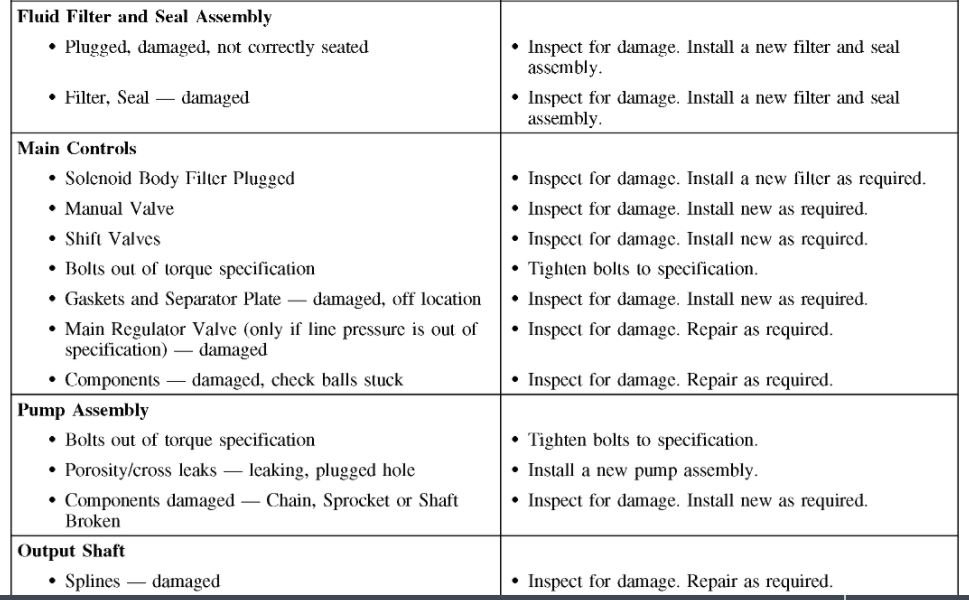

This could be low fluid, front pump failure, or torque converter failure.
It is not electrical, it is a mechanical issue when it will not engage into gear. I attached a chart for you of the possibilities.
