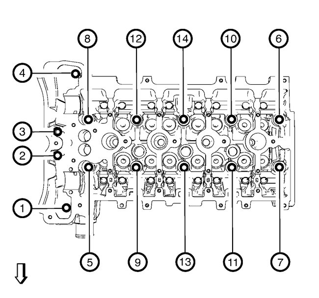

9. Loosen the cylinder head bolts in sequence as shown.

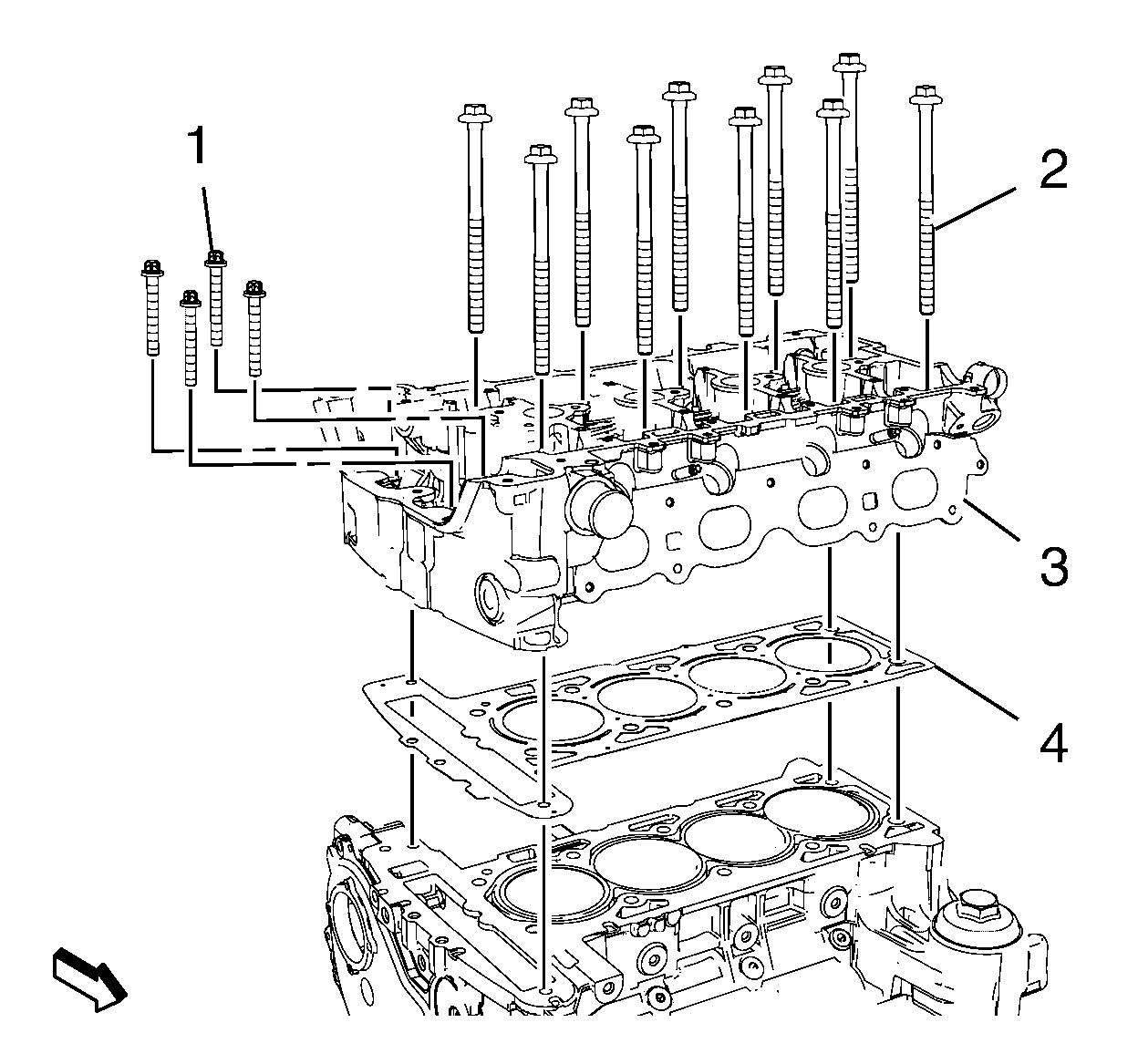

10. Remove and DISCARD the 14 cylinder head bolts (1) and (2).
11. Remove the cylinder head (3) with the cylinder head gasket (4).

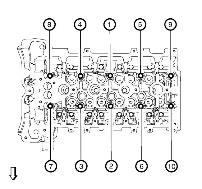

1. Install the cylinder head (3) and the NEW cylinder head gasket (4).
2. Install the 14 cylinder head bolts (1) and (2).

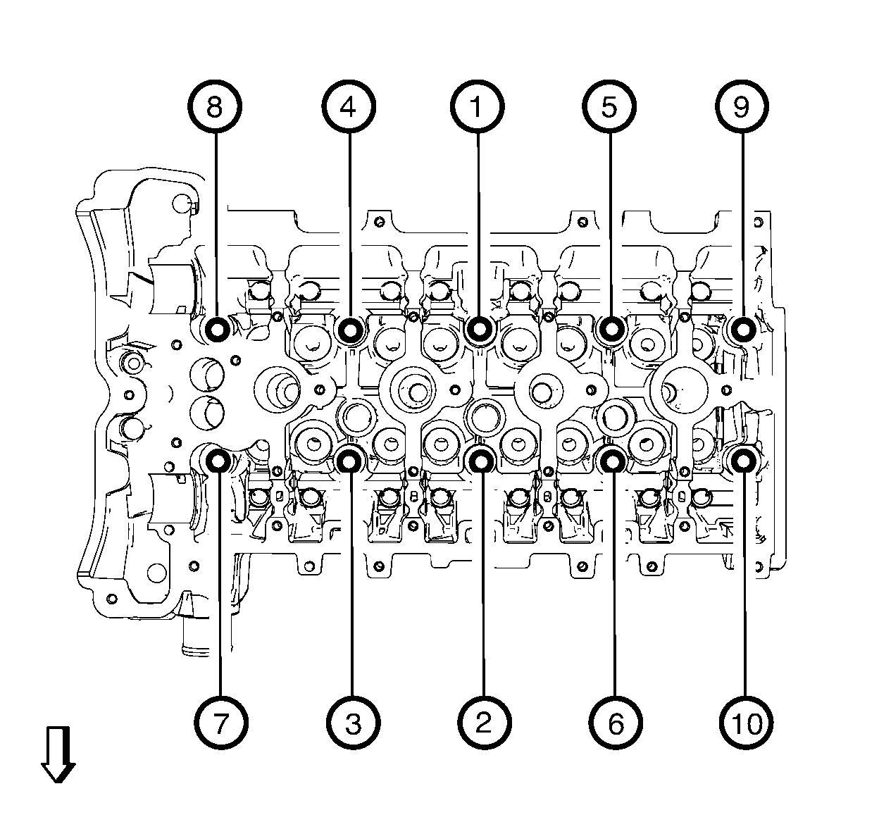

3. Fasten the cylinder head bolts handtighten in sequence as shown.
Caution:
Refer to Fastener Caution See: Vehicle > Technician Safety Information > Fastener Caution.
4. Tighten the NEW cylinder head bolts a first pass in the sequence as shown to 30 Nm (22 lb ft).
Caution:
Refer to Torque-to-Yield Fastener Caution See: Timing Components > Technician Safety Information > Torque-to-Yield Fastener Caution.
5. Tighten the cylinder head bolts a final pass in the sequence shown an additional 155 degrees, using the EN-45059 - meter.
6. Tighten the 4 cylinder head front bolts to 35 Nm (26 lb ft).
