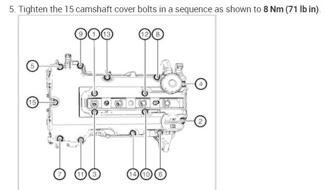

What are the torque specs for the car listed above's valve cover?

Here is the information you requested.The torque specification is 8 Newton Meters or 71 Inch Pounds. I've attached a picture below showing the proper torque sequence of the bolts. Here is a valve cover replacement tutorial:

Torque the valve cover bolts to 8 Nm (71 in-lb) in the proper sequence shown in the expert diagram, and follow a valve cover gasket replacement procedure if the cover is being resealed.
Conversation Summary
The owner asked for the valve cover torque specification for a 2012 Chevrolet Cruze. The expert stated the bolts should be tightened to 8 Newton meters (71 inch-pounds) in the proper sequence and linked a valve cover replacement tutorial.
