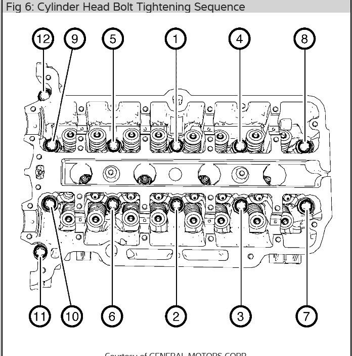

1.8 head bolt torque specs please
2011 CHEVROLET CRUZE
100,000 MILES • 1.4L • 4 CYL • TURBO • FWD • AUTOMATIC
EDGAR ARMENTA
  • 27 POSTS
If anybody could provide a diagram or picture of the sequence for torquing the cylinder head, as well as the torque specifications?
Jun 9, 2017 at 7:41 AM
HMAC300
  • 48,601 POSTS
cylinder head bolt torque is 35 Nm or 26ft lbs plus 180 degrees. See picture for sequence. all bolts must be torqued to 35 prior to additional degrees.

I’m looking for the torque setting on the car listed above cylinder head.
Jul 16, 2020 at 1:21 PM (Merged)
Good morning,
Can you verify the motor?
I list a 1.4 and 1.8 engine.
ALEGRA
It is a 1.6, but i managed to get hold of the settings. Thanks a million.
