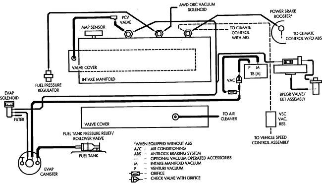

A diaphragm vacuum diaphragm.
Aug 21, 2025 at 1:11 PM
MECHTRIX
Experienced Mechanic
575 POSTS
Heres the diagram should be everything there. hope this helps good luck.
Image (Click to enlarge)
