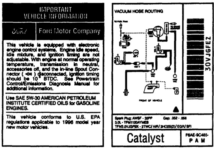

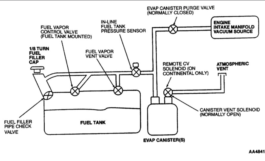

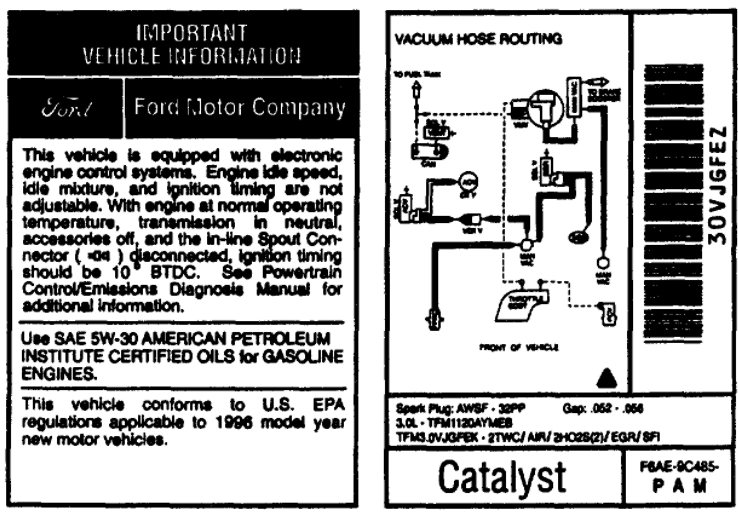

vacuum routing diagram needed
1999 MERCURY SABLE STATION WAGON
15,500 MILES
SEAN MURPHY2
MEMBER
1 POST
broke lines.
Dec 19, 2020 at 3:47 AM
DANNY L
Experienced Mechanic
5,648 POSTS
Hello, I'm Danny.
Here is the information you requested. I found 2 diagrams one is for emissions the other is vacuum. I've attached them below. Hope this helps and thanks for using 2CarPros.
