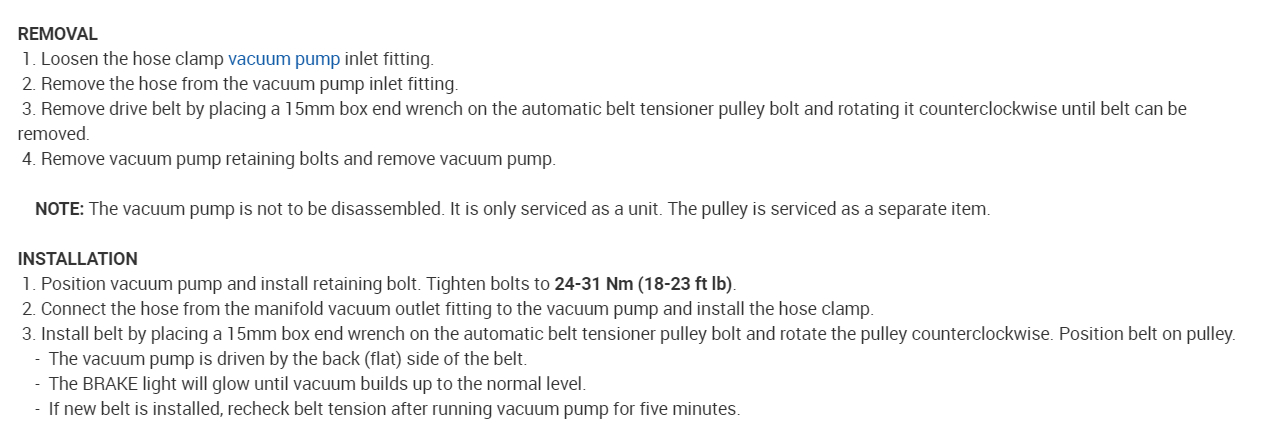

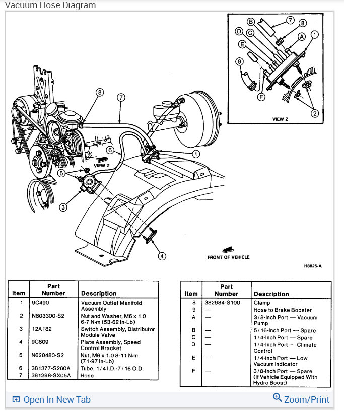

Does anyone know the torque specs on the vacuum pump pulley? I installed a reman pump and the pulley is chattering and my belt is squealing.
Jul 14, 2023 at 9:02 AM
Experienced Mechanic
55,616 POSTS
Here are the torque specs they offer but by looking at the diagram the pulley looks pressed on.
Vacuum Pump to Bracket Bolts .................... 24-31 Nm (18-23 ft lb)
Low Vacuum Indicator Switch bracket screws .................... 8-11 Nm (6-8 ft lb)
