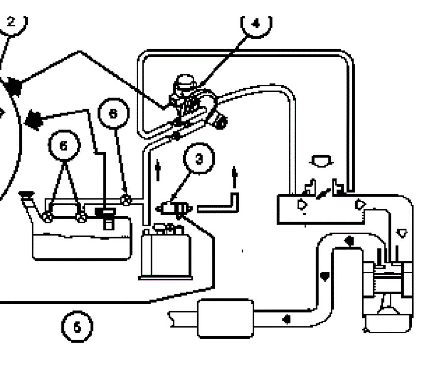

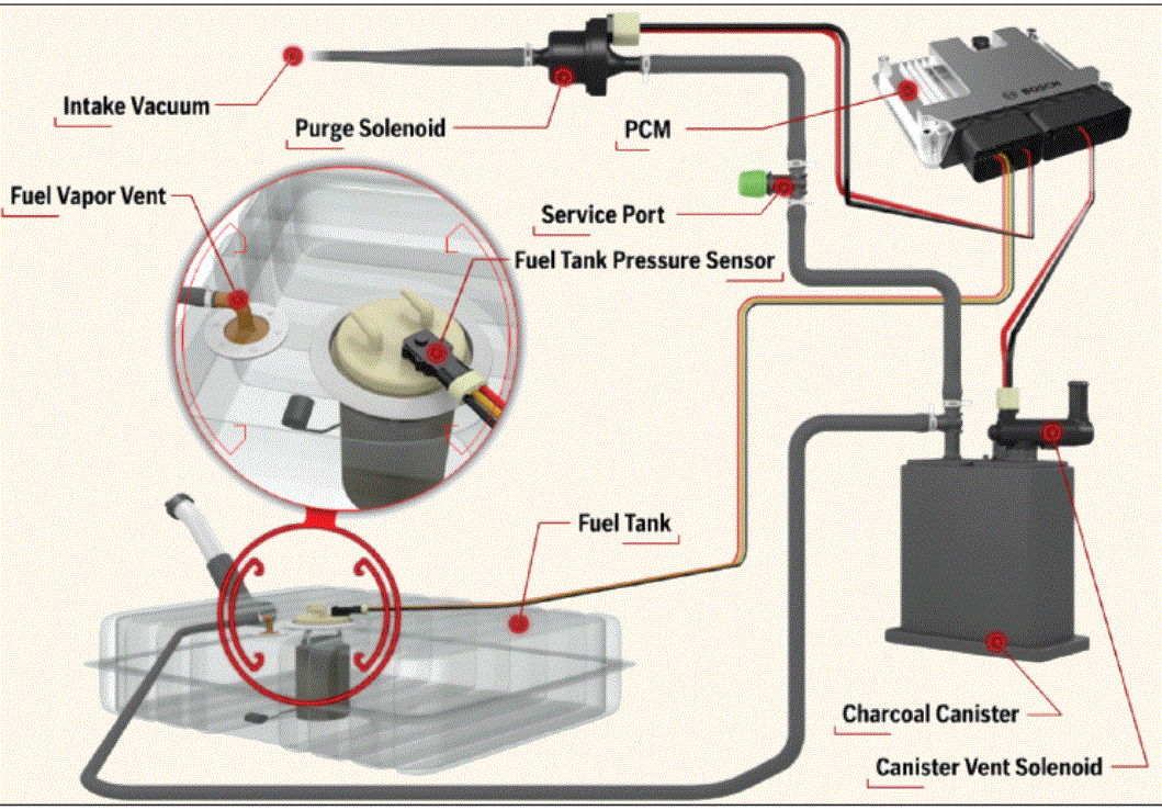

How many vacuum lines come from the back of the engine and where do they go?
Sep 26, 2021 at 6:03 AM
  • 110,248 POSTS
For some reason, my manuals are not providing a vacuum schematic for this vehicle. However, I was able to find a couple of things that may help.
If you look at pic 1, that shows the vacuum hoses specific to your vehicle's emissions system (EVAP). Pic 2 shows a general design that Ford uses.
Now, there should be a vacuum schematic label under the hood. If possible, take a pic of it and upload it for me to see. From that, I can tell what your vehicle came with.
Also, if you are trying to find a vacuum leak, here is a link that explains how it's done. I will also tell you that there is a vacuum hose that comes off the rear of the intake and has a 90-degree turn in it. The turn is a common failure issue due to dry rot. They crack and leak.

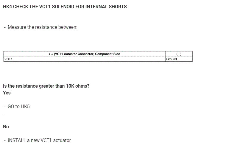

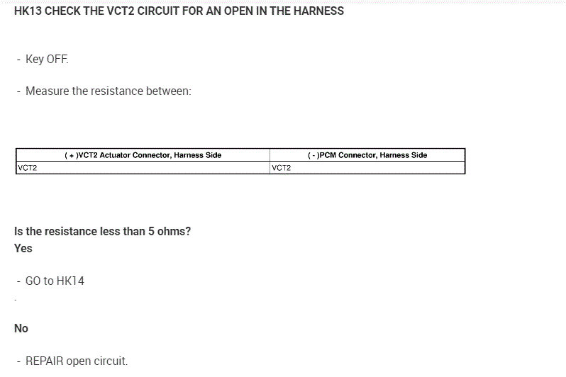

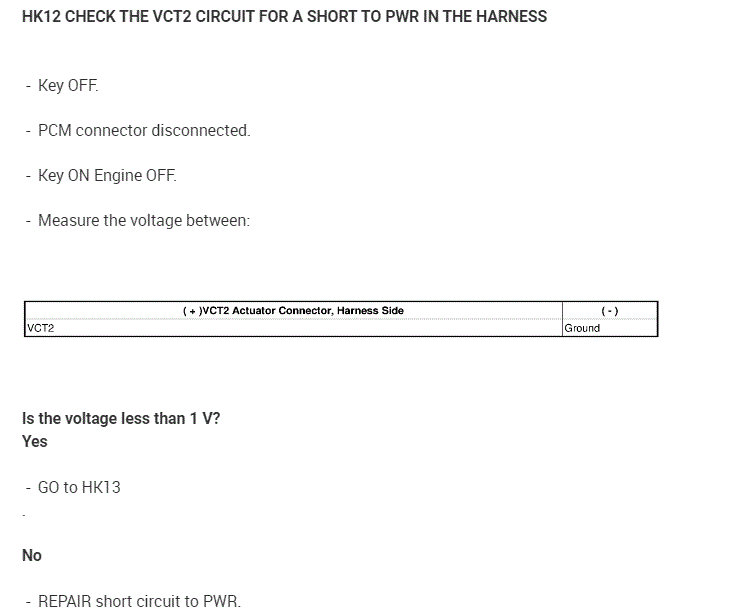

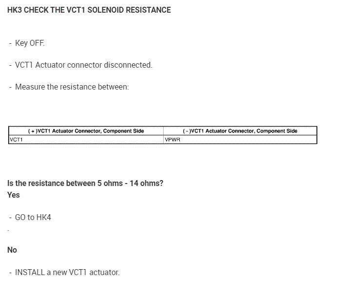

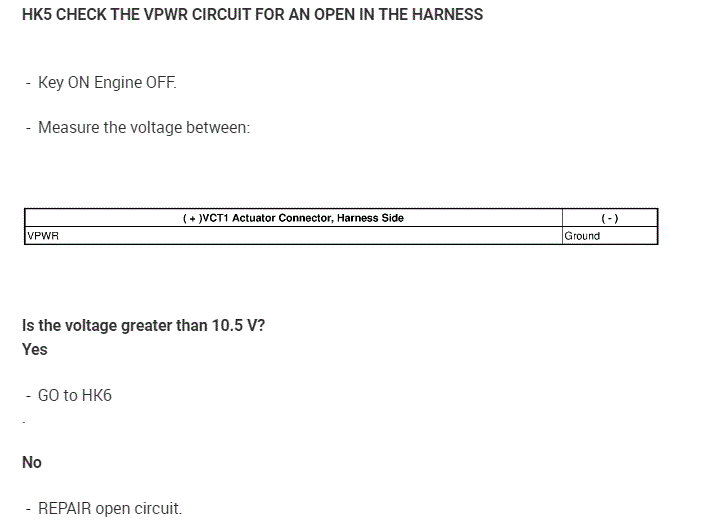

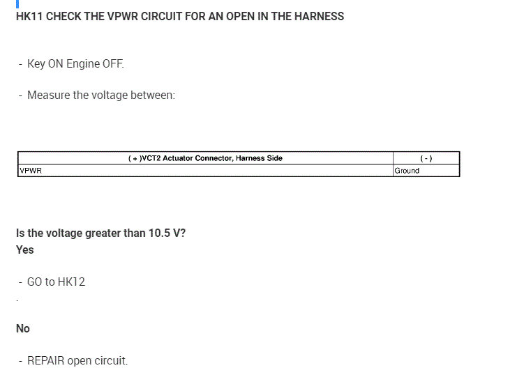

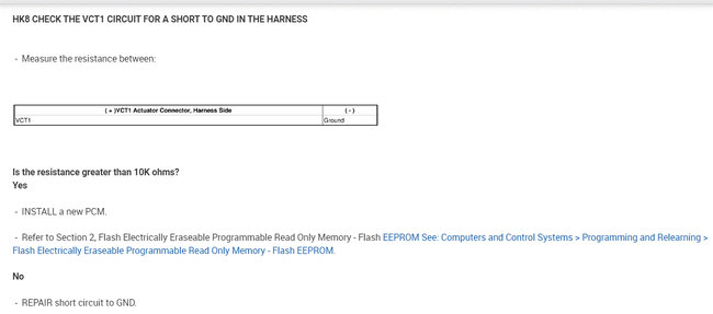

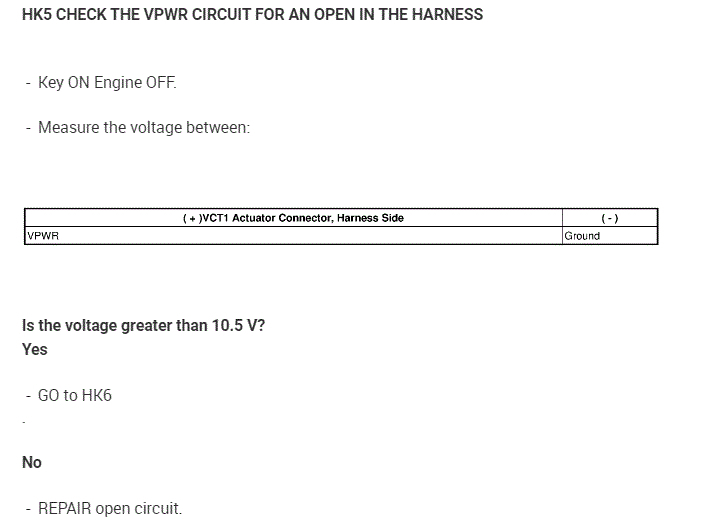

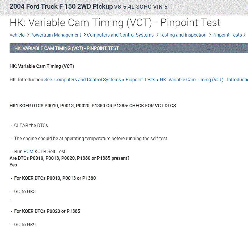

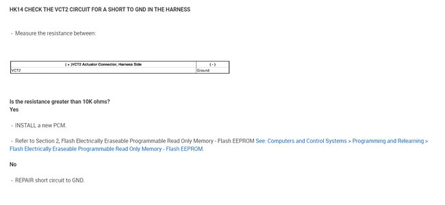

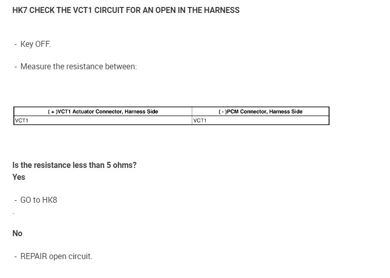

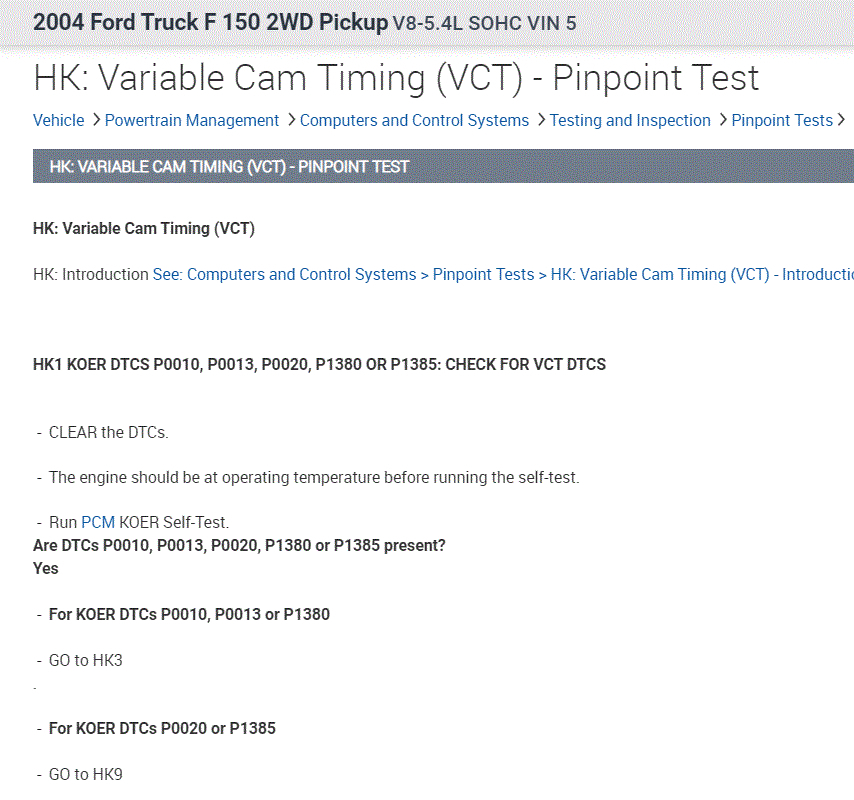

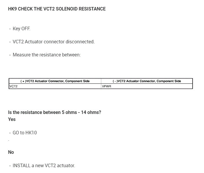

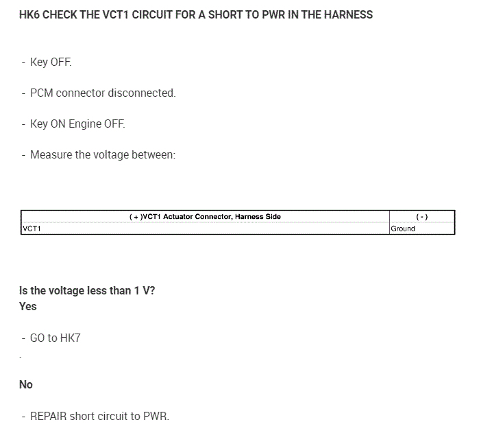

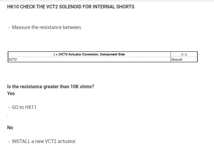

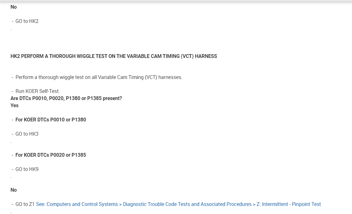

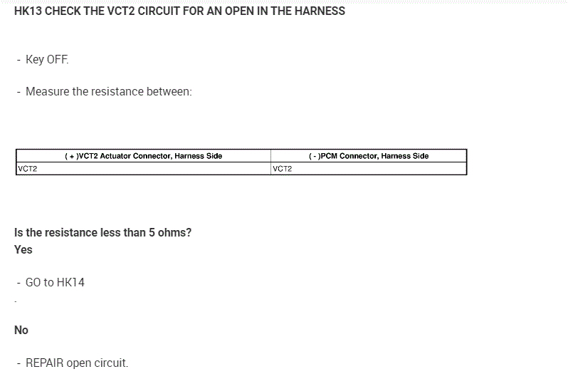

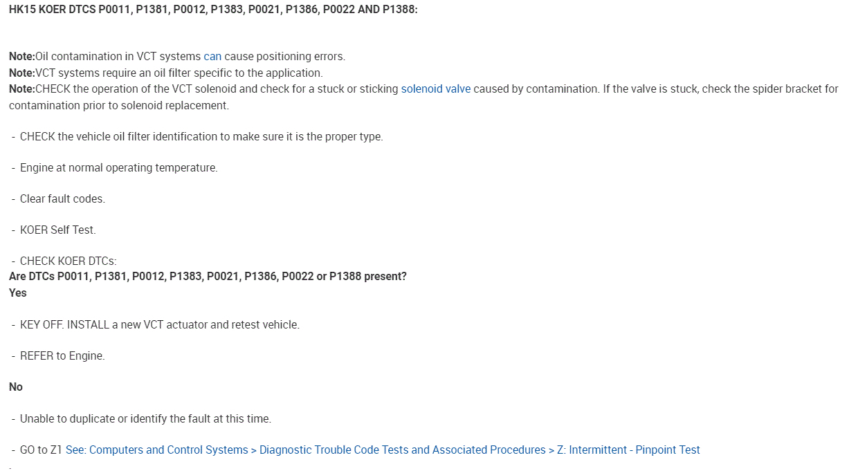

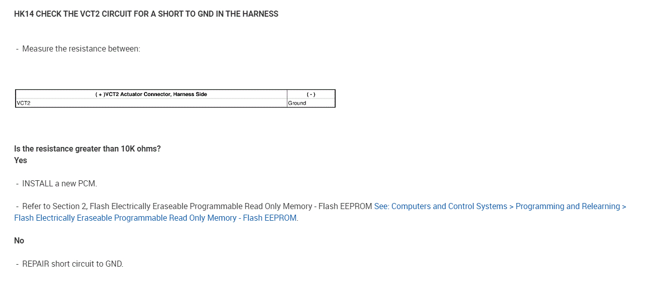

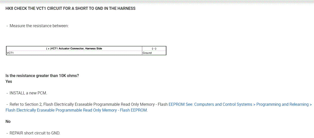

I need to pursue some other issues with this truck that I now have 225,500 miles on the truck. Last summer I started pulling codes p0011 p0021 and p0435 and p0420. I replaced the timing chains and guides etc., and new phases and VCT valves. The truck runs fine but I am still pulling the same codes. any suggestions?
Jun 10, 2022 at 4:32 AM
  • 110,248 POSTS
Sorry to hear you are still dealing with this. The codes are somewhat interesting. Two of them deal with a catalytic converter issue, and the other two (which I believe you already know) deal with variable timing.
Since you have already replaced the components related to the timing, it is likely a short or open circuit keeping the P0011 and P0021 stored. Which would lead me to follow testing designed to pinpoint the specific cause.
I have attached them below. Take a look through them and let me know if you are comfortable performing them. Also, the catalytic converter codes are likely indicating a need for replacement. One is a temperature indicator and the other indicates the converter is operating below threshold.
Take a look through these and let me know your thoughts.

KDCHRIST
  • 39 POSTS
I finally got around to tracing out the wiring. I found the problem fairly quickly. There was a broken wire on the bank2 cam ting sensor. I bought a new plug and wired it in, and I am code free. Now I am ready for inspection in Feb of 2023 here in DE. Thank you so much for your input.
