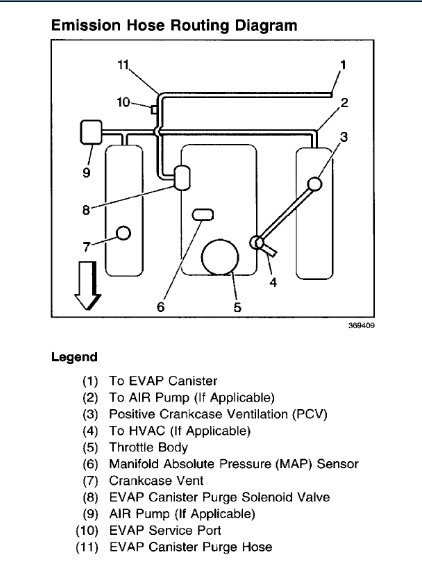

Vacuum lines from air pump to EGR PCV vacuum Solenoid diagram needed?
2001 CHEVROLET BLAZER
160,000 MILES • 4.3L • 6 CYL • 4WD • AUTOMATIC
STEPHEN ACUNA
VIN-w, 4.3L V6, Central port fuel injection(cpi). I am looking for the correct vacuum diagram coming from air pump to Air vacuum controls Illinois to air shut off valve to air check valves.
VIN-w, 4.3L V6.
Oct 24, 2022 at 1:12 PM
  • 110,194 POSTS
I went through two different manuals and only found one pic. I attached it below. Take a look at it and let me know if that is what you need.
I hope it helps.
See pic below.
