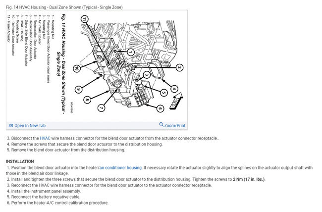

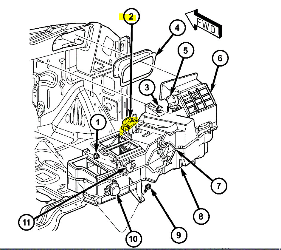

Thanks for the info! This truck has dual slider knob temperature control for the A/C, one for driver and one for passenger. When /AC is on, cold air only comes from driver side (yeah!) but it's warm on the passenger side regardless of the position of the slider knob. I am thinking its a blend door problem, but I don't have ability to remove whole dash. I attempted to remove the panel around the radio to see if I could check the slider potentiometer but was not successful. I also thought if I could remove the panel and if I could reach the door, I could tie it in the open position.
I think the mode selector is not working as I only get air from the top vents but better than no air at all.
Thanks for the help!
Jun 11, 2022 at 5:18 AM
  • 110,240 POSTS

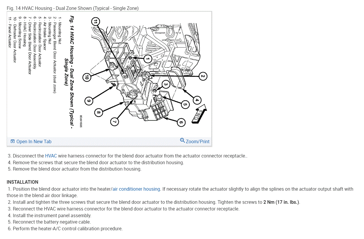

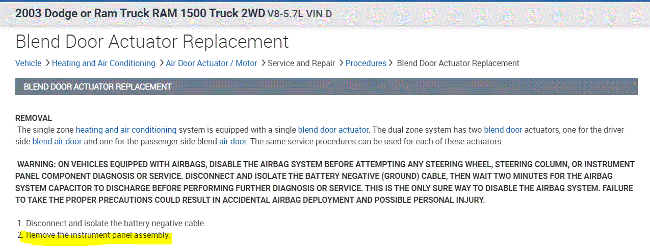

If you look below, I provided the directions for replacement. The first pic shows its location. The remaining pics are the directions. I highlighted the second line which is a bit frustrating. See if you can gain access without removing the entire panel.
Jun 11, 2022 at 12:59 PM
DAISYGIRL8688
  • 57 POSTS
Thank you very much for the diagrams. This appears to be a quite a long job and requires removing the dash and ac and heater lines. I found these videos which does a good job of showing what has to be done:
