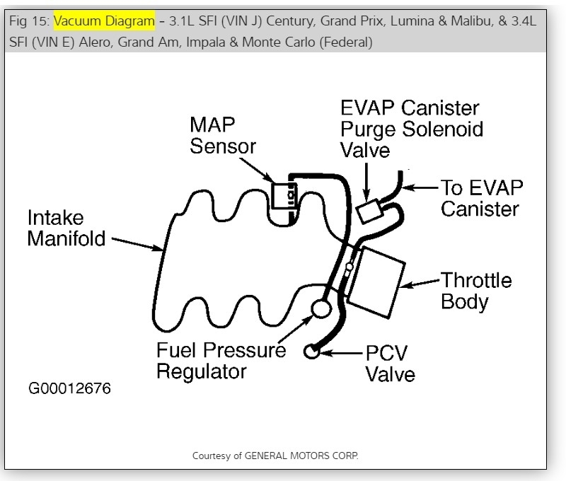

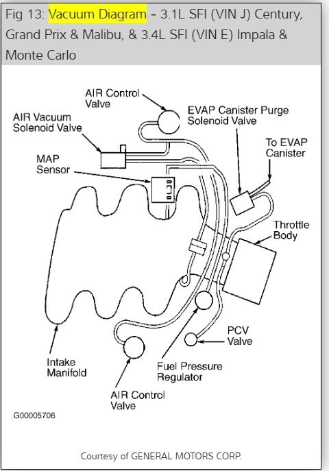

I changed the thermostat and when putting it back together couldn't remember where all the vacuum lines go, I need to see where they go.
Sep 1, 2023 at 2:37 AM
CANNON1349
  • 861 POSTS
I attached the possible vacuum diagrams below. Depending on your specific VIN and configuration it may be different so I included both. Let us know if you need anything else!

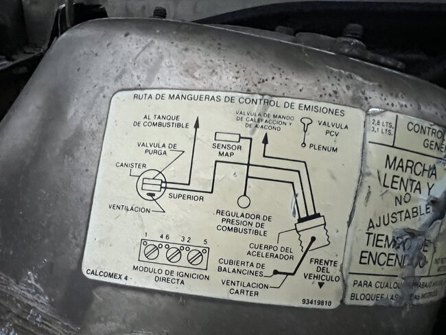

This is 1996 Buick century limited hose routing diagram added in the car, so. Is this a wrong connection?
Jun 20, 2025 at 11:19 PM
  • 55,686 POSTS
If you are asking if this is wrong for a 2001 then I would say probably it might not be correct.
