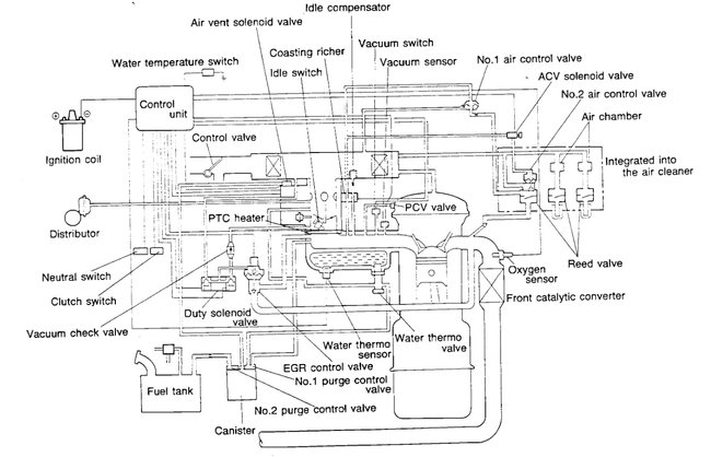

I need a vacuum diagram.
May 29, 2022 at 10:23 PM
  • 55,399 POSTS

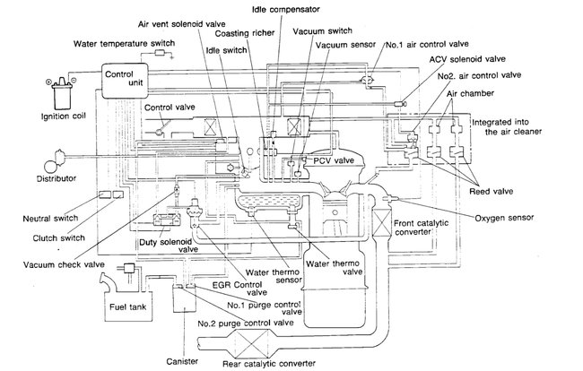

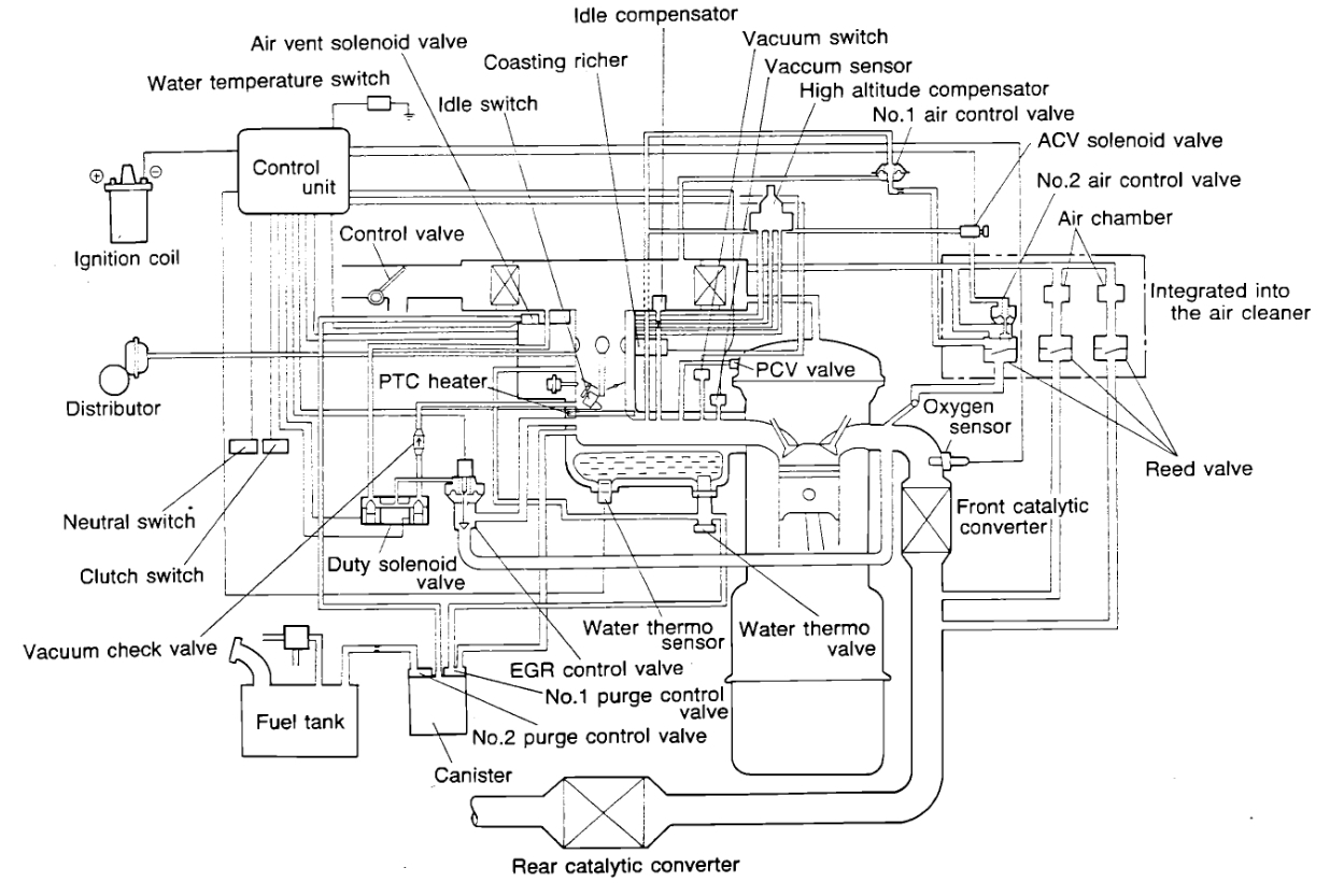

There are three different styles of vacuum line diagrams which are California, Canada and Federal I have included all three of them with a guide on how to check for vacuum leaks.
