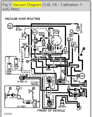

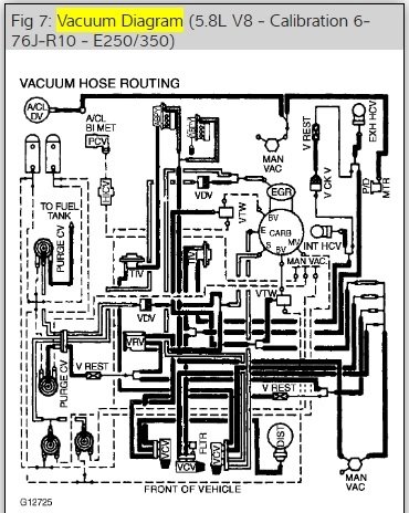

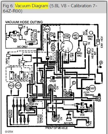

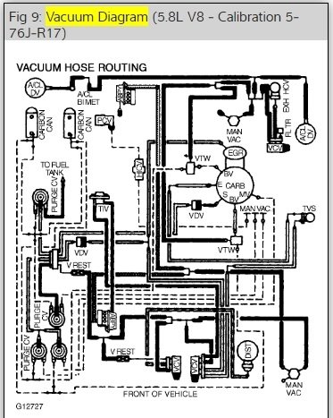

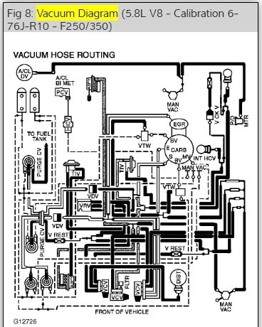

I am looking for a diagram for vacuum lines on my 1987 Ford e350 1 ton cutaway. 5.8L 351 Windsor. It has two smog pumps. Thank you

Look at your decals.
I got these from "Prodemand"
One of the five ought to be you.
