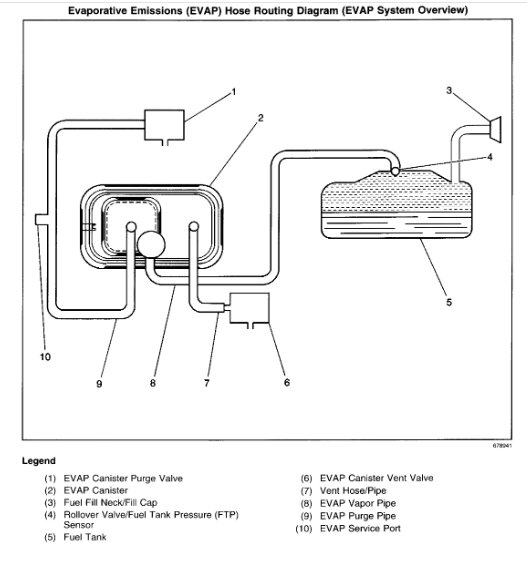

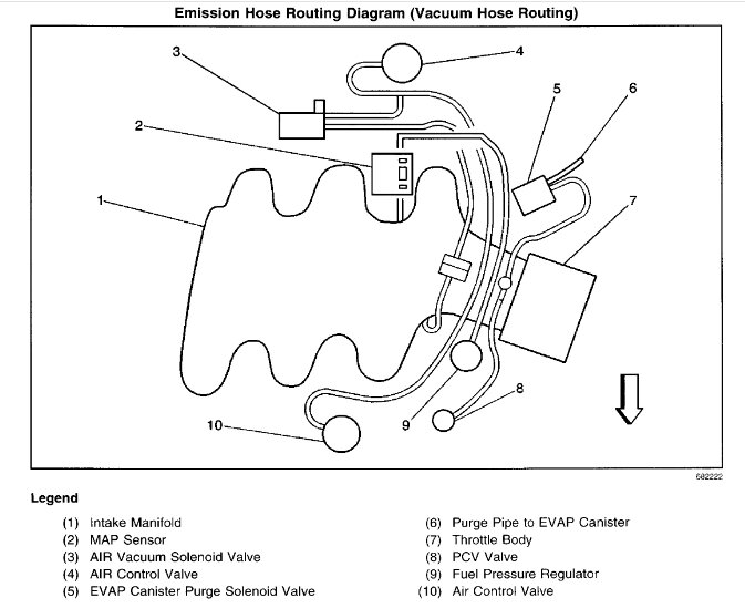

My friend is stranded at my house. He has a Vacuum line that got disconnected but doesn't know where it goes, and we can't find diagrams. Very rough idle, actually had muffler explode, backfiring, sputtering out and shutting off. please help!!!

How big is the vacuum hose? Where on the engine is it located? If you could take a few pics and upload them for me to see, it may be helpful.
As far as the schematics are concerned, I attached the only two I have. Let me know if they help. Also, here is a link you may find helpful:
See pics below. Note: Pic 1 is looking straight down on the engine from above.
