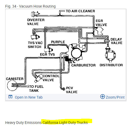

I need a vacuum line diagram for 454ci motor. Calif.emissions.chev.C20.

Because of the model year, my manuals are somewhat limited. However, I did find a vacuum schematic for a CA emissions specific to your vehicle.
Take a look at the schematic and let me know if it helps. Also, if you are trying to find a leak, here is a link you may find helpful:
See pic below.
