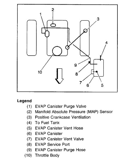

200,000 MILES • 5.7L • V8 • 4WD • AUTOMATIC
JAWALKER
I recently removed my vacuum lines for a valve cover replacement and did not make them and some broke. I need a diagram for the vacuum lines please.
Apr 23, 2023 at 1:03 AM
  • 110,248 POSTS

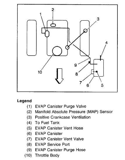

You have the same kind of luck as I do. LOL As far as the vacuum hoses are concerned, I attached the only vacuum schematic I have below. Take a look through them and let me know if it helps or if you have other questions.
Also, if the schematic doesn't provide something you need, take a pic of the problem area and upload it for me to see, hopefully, I'll recognize it.
See pic below.
