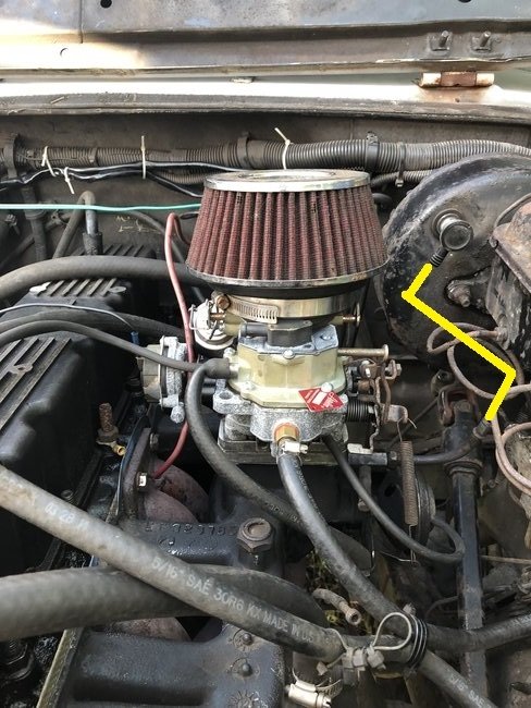

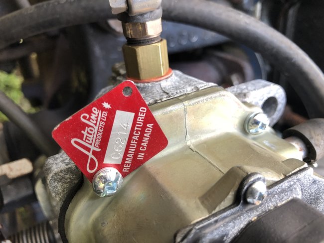

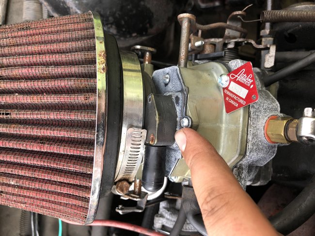

The vehicle was running good parked it for about six months tried to start it up bust up bad, got to constantly give gas to keep running. So I got a new carburetor ran good when I idling, then started acting up like before. Everyone says it is a vacuum leak but I have no idea. I had a new motor put in before it was parked and I do not know what year it is. The Jeep is a 1988, but the motor I believe is a 1979, do not know for sure. The numbers I found (ef3235444) brought me to the 1979 the carburetor is a (auto line c6214) and a lot of the lines around it were blocked off from the people who put the motor in. So I am trying to find out where the lines go. I do not believe they are there for nothing.

This is a Carter BBD carburetor most likely from a 1979, give or take a year.
Very good carburetor.
This Jeep has a "straight six" cylinder engine, not a V-8 as in your information above.

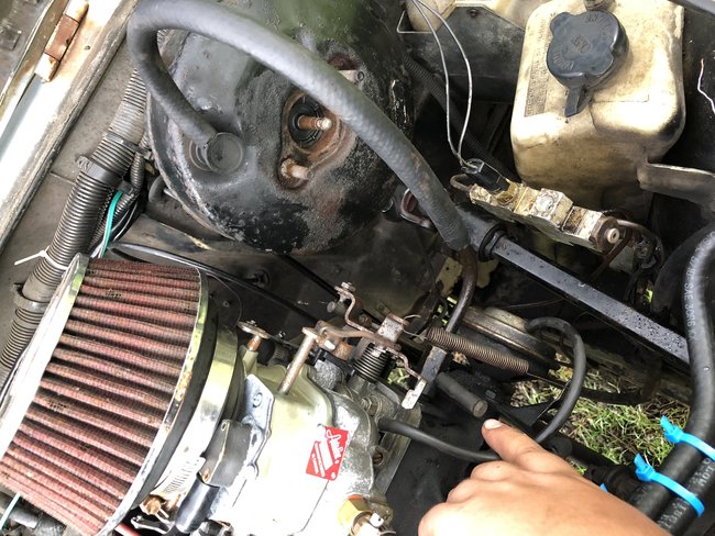

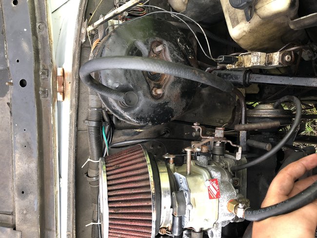

I noticed in your pictures that the brake booster does not have vacuum line to it, and there is a large vacuum port "open" on the driver's side of the intake.
Did you remove this line?
Do you understand?
See my two pictures below.
If this is not the issue, I may still be able to aid you in getting it right.

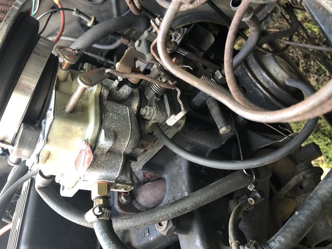

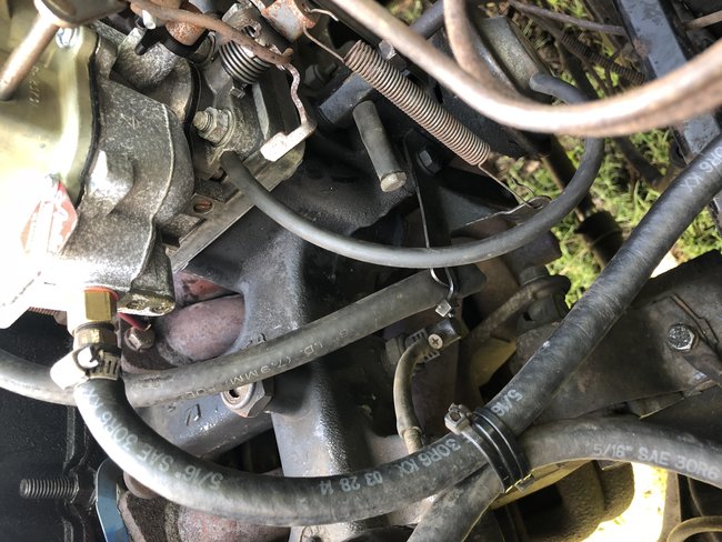

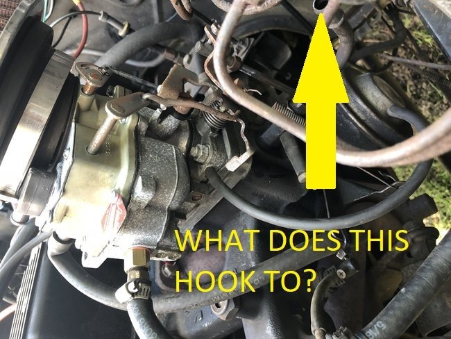

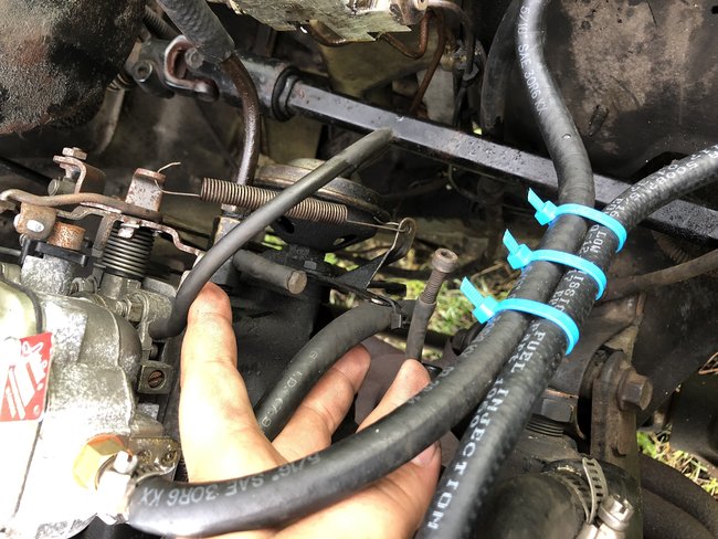

That was the brake booster vacuum line had a hole I have replaced that hose the ones. I am pointing to in the pictures are the ones I am trying to find where they go. Also, I want to make sure everything is going to were it is supposed to be.
