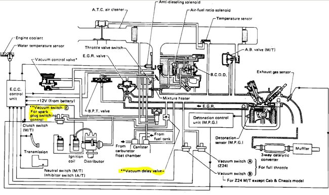

Vacuum line routing diagram
185,000 MILES • 2.4L • 4 CYL • 4WD • MANUAL
UGABUGA
Truck listed above is a 720, z24 California smog.
I'm in dire need of vacuum line diagram. Help!

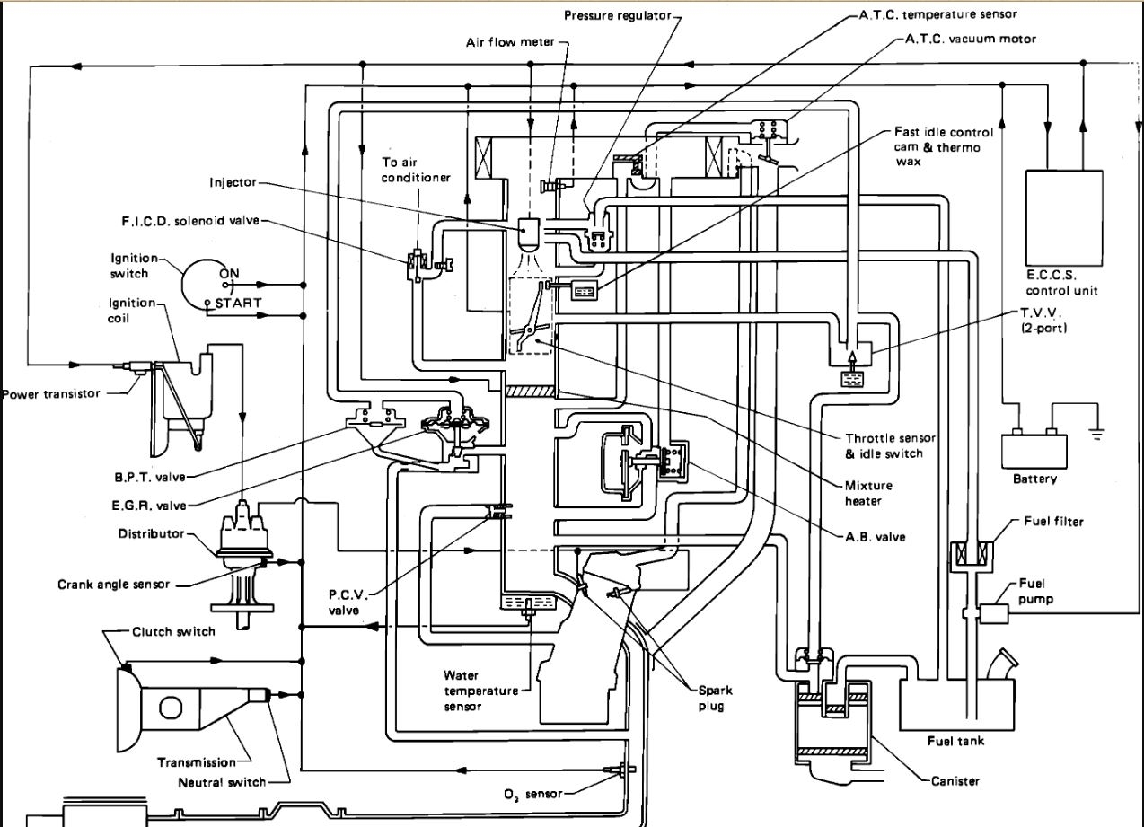

Try these. The first is for the fuel injected version the second for the carbed engine. The yellow highlights are parts not used on a California emission engine. Check out the diagrams (Below). Let us know what happens and please upload pictures or videos of the problem.
