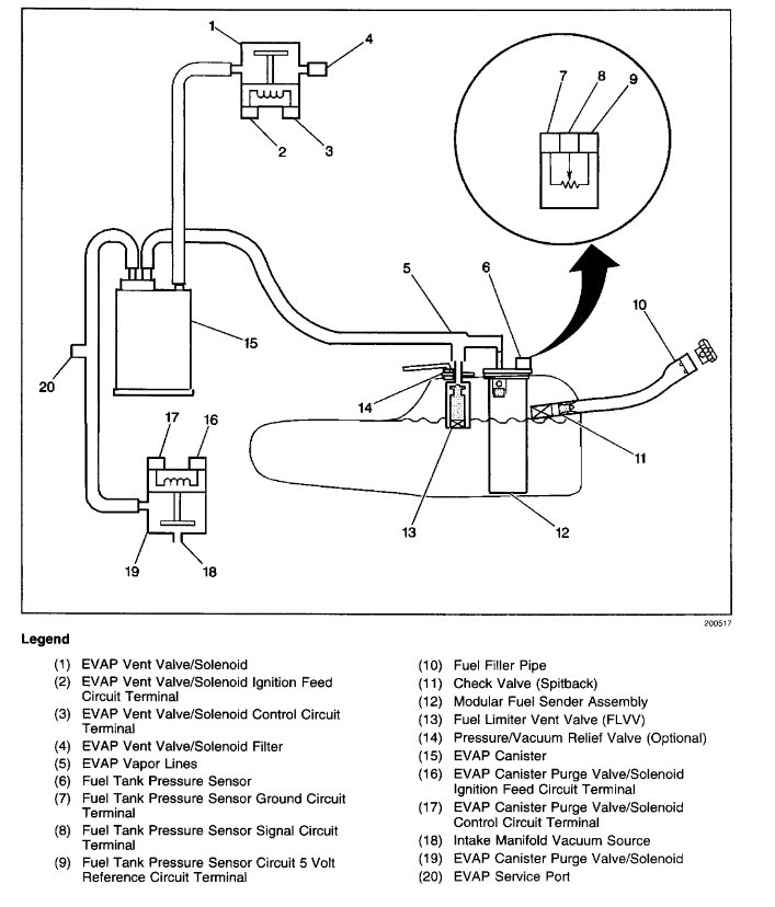

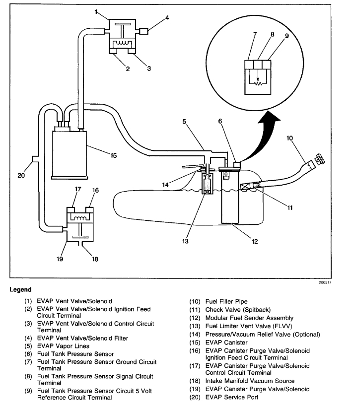

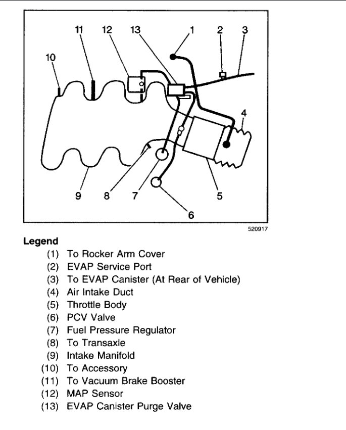

From the front of the vehicle the airport on the intake manifold that runs to the transmission is missing, I need to know where on the transmission it goes. I can't locate the transmission Port.
Sep 21, 2022 at 4:00 AM
  • 55,423 POSTS
There is no vacuum line that goes to the transmission but here is the vacuum one diagram for the engine so you can see where the lines go. Check out the images (below). Let us know what happens and please upload pictures or videos of the problem.
