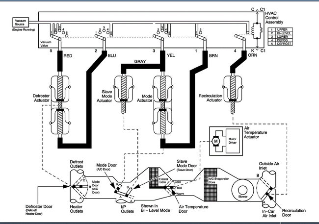

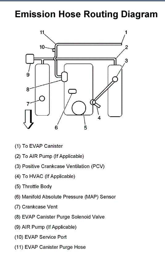

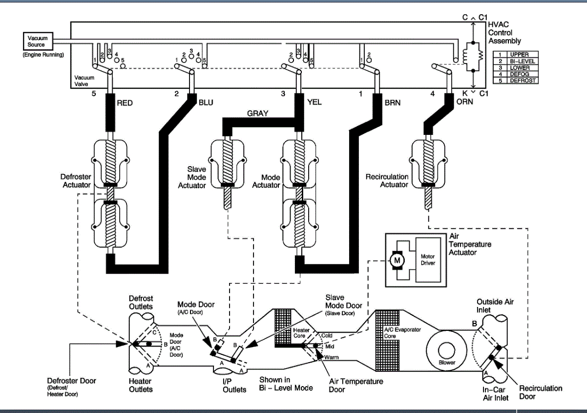

Need diagrams for the vacuum lines on my 03 Chevy Blazer LS; X, 4dr 4wd vortex 4,3 liter v6 automatic
Apr 30, 2022 at 12:44 PM
  • 110,194 POSTS
I'm not sure if you are looking for a leak or not. However, if you are, here is a link that explains how to locate one.
As far as the vacuum schematics, I attached what I have below for your review. The first one is for the EVAP/emissions control system. The second is for the HVAC system.
Take a look through them and let me know if you have questions.
