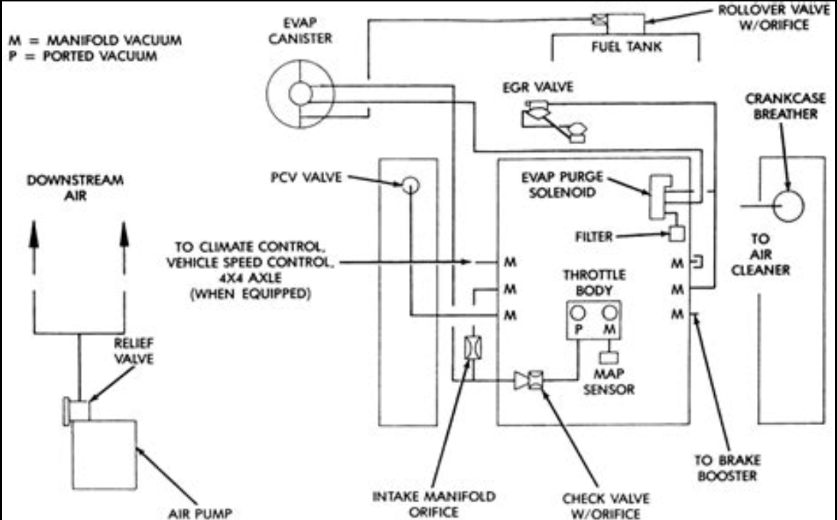

Can someone give me tje vacuum line diagram?

It is a little fuzzy but there is the engine vacuum line diagrams. Check out the images (below). Let us know if you need anything else.

Thank you so much!
