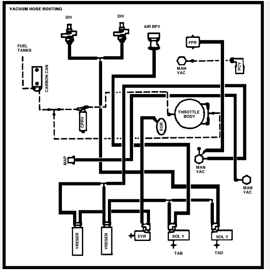

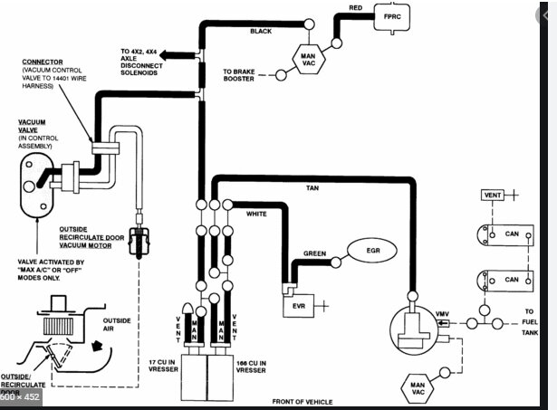

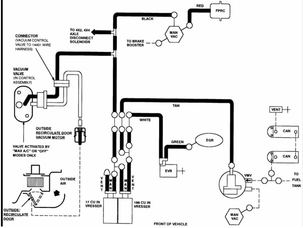

I need a complete list of all vacuum lines.
Aug 29, 2023 at 5:14 AM
Experienced Mechanic
55,740 POSTS
Sure, here are all of the vacuum line diagrams I could find for you. Check out the images (below). Please let us know if you need anything else to get the problem fixed.
