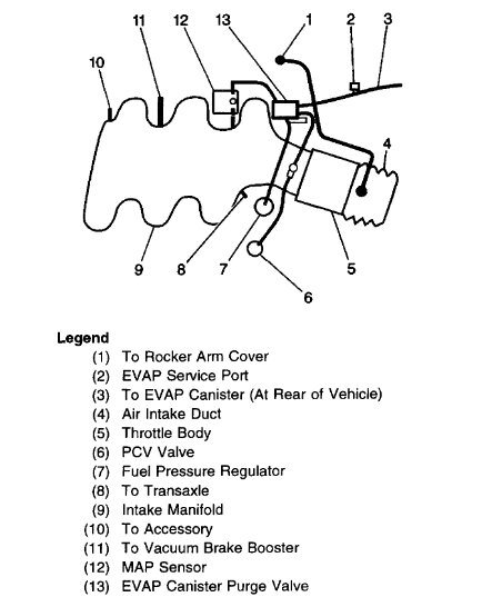

I need the vacuum line diagram for the car listed above.

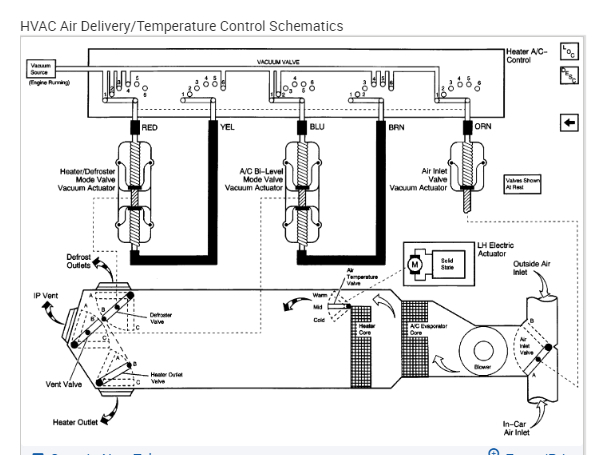

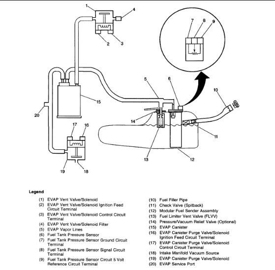

If you look below, I attached the vacuum schematics from my manual. The first two are related to the emissions/engine system. The last pic is for the HVAC system which parts of it are controlled by vacuum.
