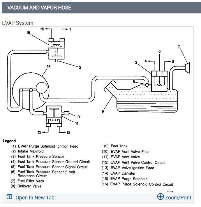

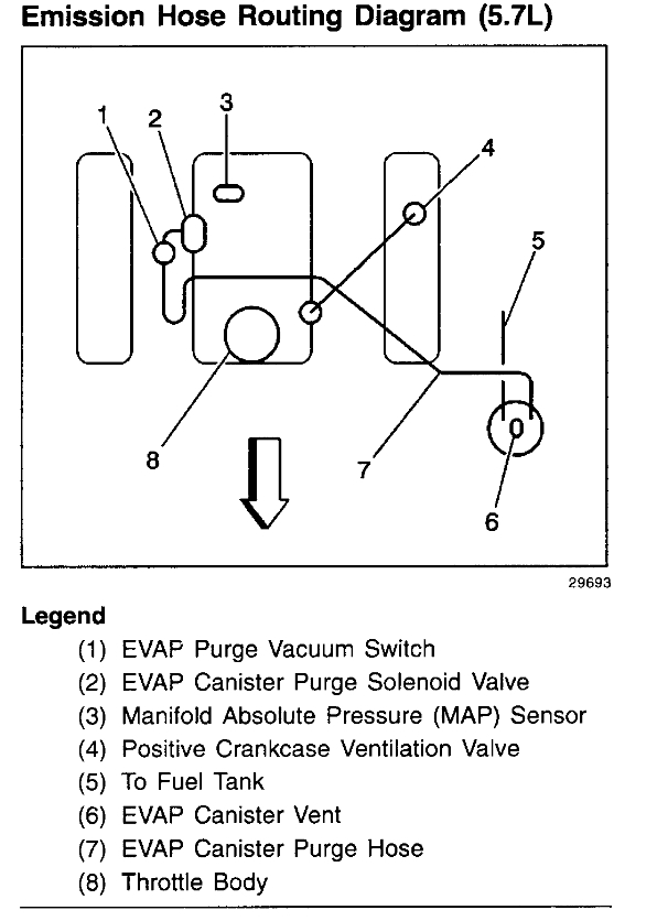

I need a vacuum diagram for the vehicle listed above 1500 5.7 vortec.

Sure, here are the engine and emission system vacuum line diagrams. Check out the images (below). Let us know if you need anything else.

Sorry it took so long to respond. I don't know if that's right or not. I'll send pictures in the morning.
