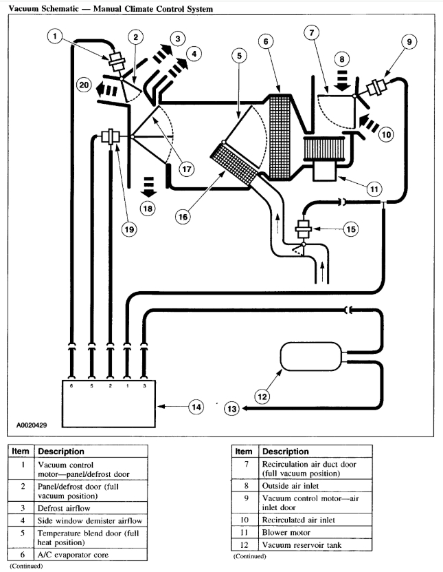

Vacuum line broke, A/C only will blow out defrost?
2002 FORD EXPLORER SPORT TRAC
340,000 MILES • 4.0L • V6 • 2WD • AUTOMATIC
JOEY BREWER
MEMBER
1 POST
I need a vacuum line diagram to fix vacuum line.
Apr 1, 2025 at 12:51 PM
Experienced Mechanic
55,649 POSTS
Hello Joey,
Yes, this is a common problem, here is a guide that should be able to help you fix it:
https://www.2carpros.com/articles/air-vents-stay-in-the-defrost-position

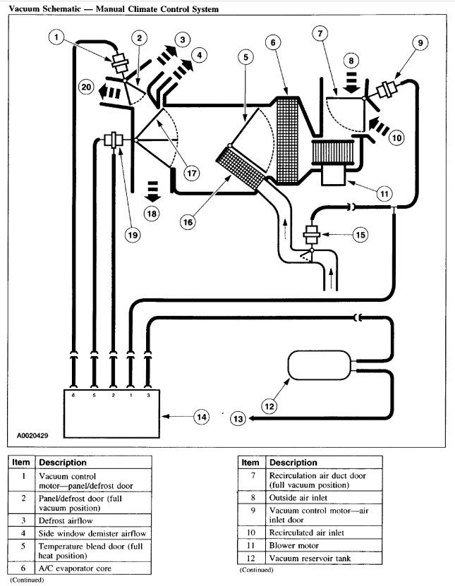

Here are the HVAC vacuum line diagrams as requested. Check out the images (below). Let us know if you need anything else.
