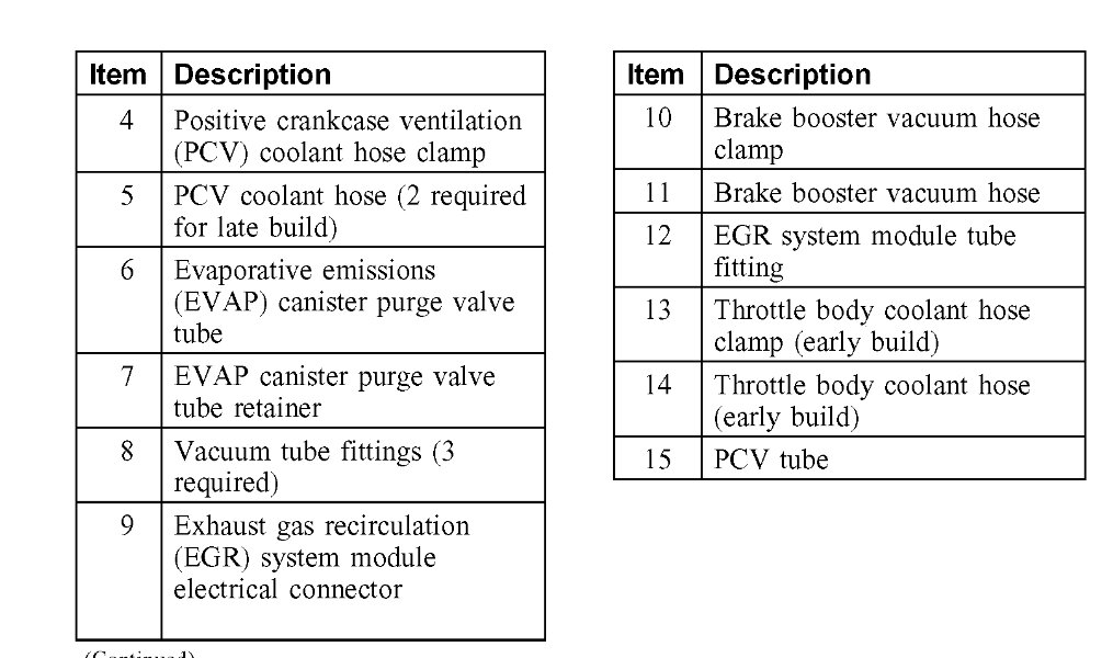

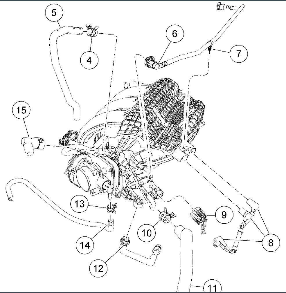

I need a diagram for all the hoses under the hood?
Apr 16, 2023 at 3:17 PM
AL514
  • 5,639 POSTS
Hello, you need all the vacuum hoses and PCV hoses for on top of the engine going to and around the intake manifold? Anything else?
Was the upper Intake Manifold removed? Only asking because service info is showing a Secondary Air Injection setup which directs air into the exhaust manifold on this vehicle and has different solenoids, air diverter valves and larger hoses to the air pump that can look almost like coolant hoses but they're not.

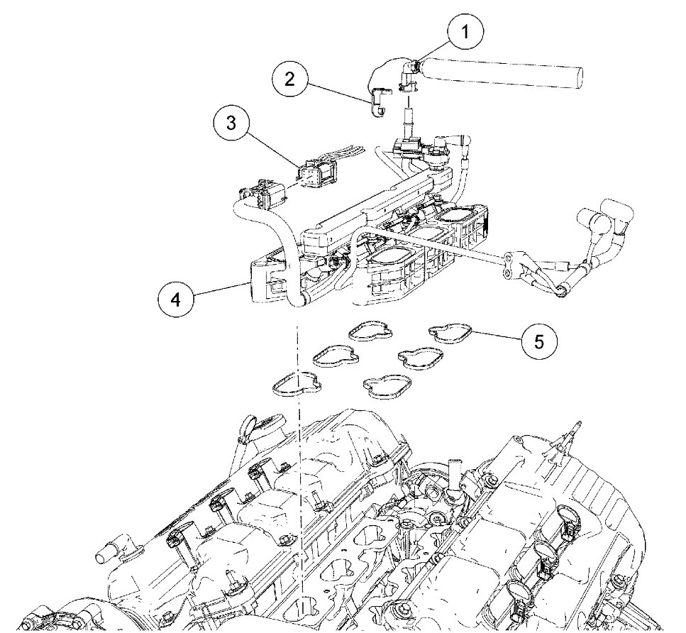

The 1st and 2nd diagrams are the Lower section of the Intake manifold, it rests between the two valve covers in the valley of the V6 engine.

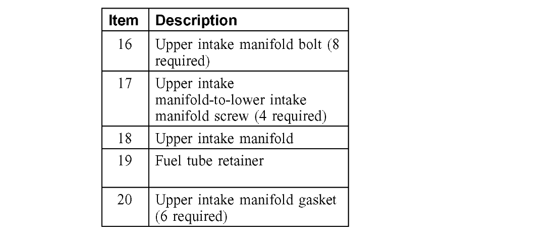

Diagrams 3 and 4 are the Upper Intake Manifold (plastic) from more of a front view, at the bottom of the picture you can see the oil fill cap and oil dipstick.

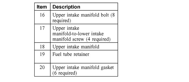

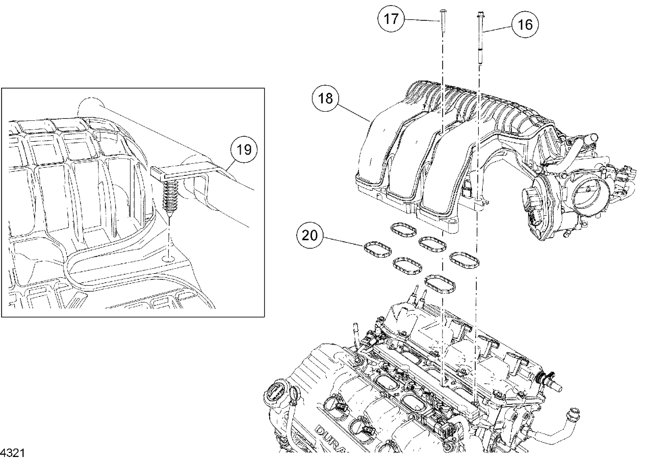

Diagrams 5 and 6 are a side view of the Upper Intake manifold. This is where most of the vacuum hoses, hose to the Brake Booster (11), the Throttle Body just above the number 13 is where the air intake tube from the air filter box will come to.
