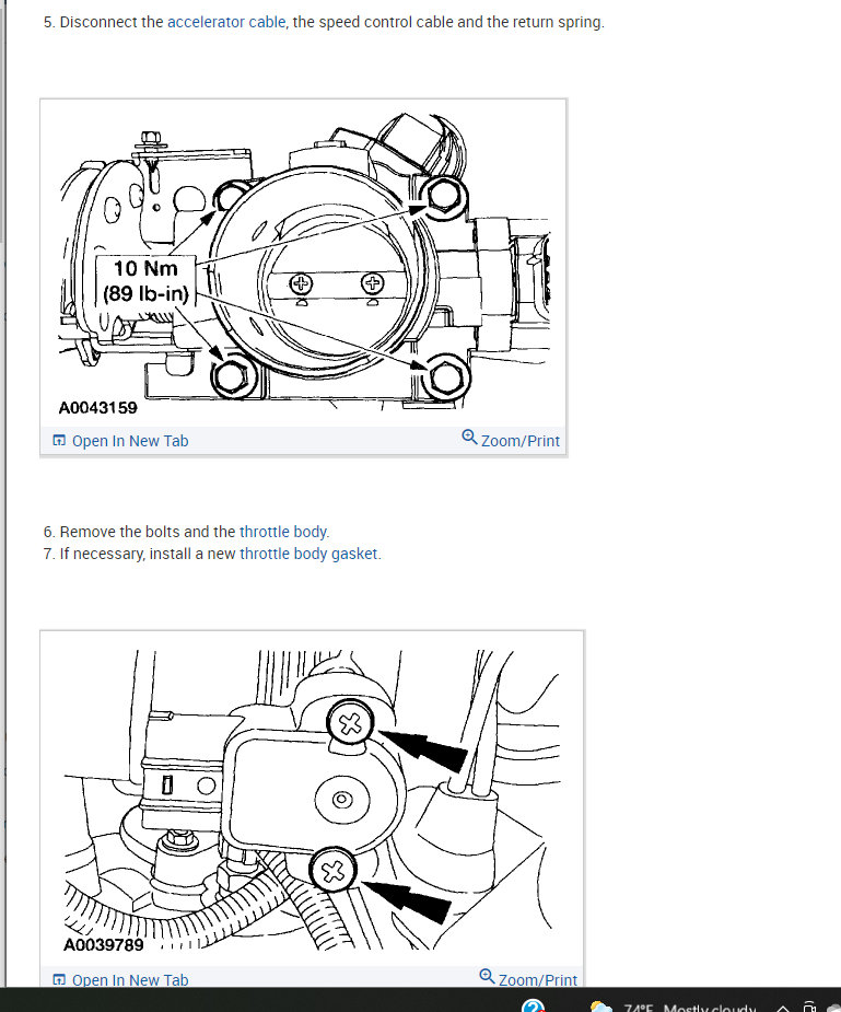

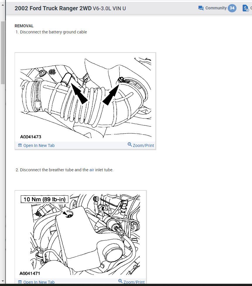

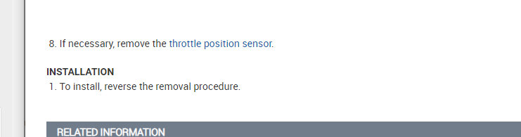

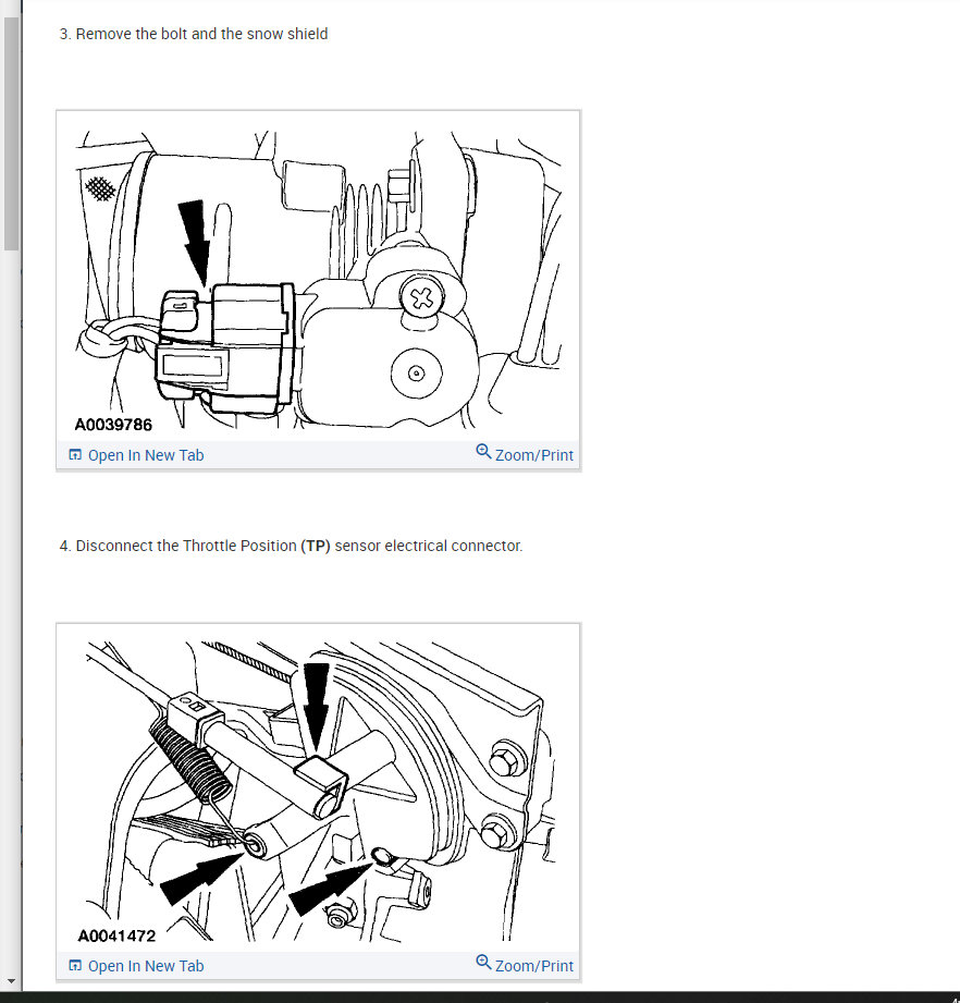

How to take off throttle body? Vacuum line.
Jun 23, 2021 at 10:56 AM
Here is a guide that will help with removing the throttle body off a similar vehicle:
https://www.youtube.com/watch?v=StA9YXMgcBw
Below you will find the process from the manual on how to remove the throttle body on this vehicle.
Please run through this material and let us know if you have other questions. Thanks
