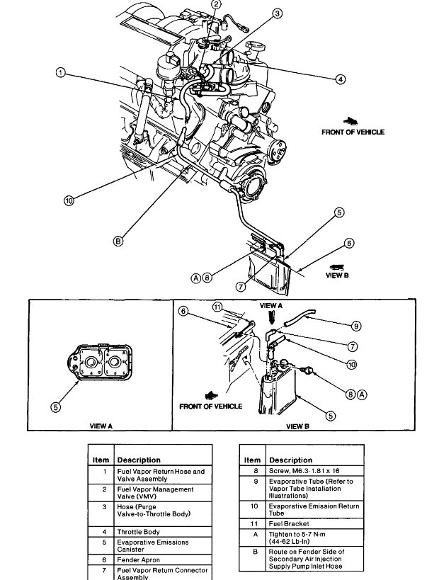

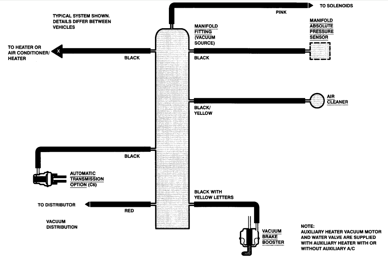

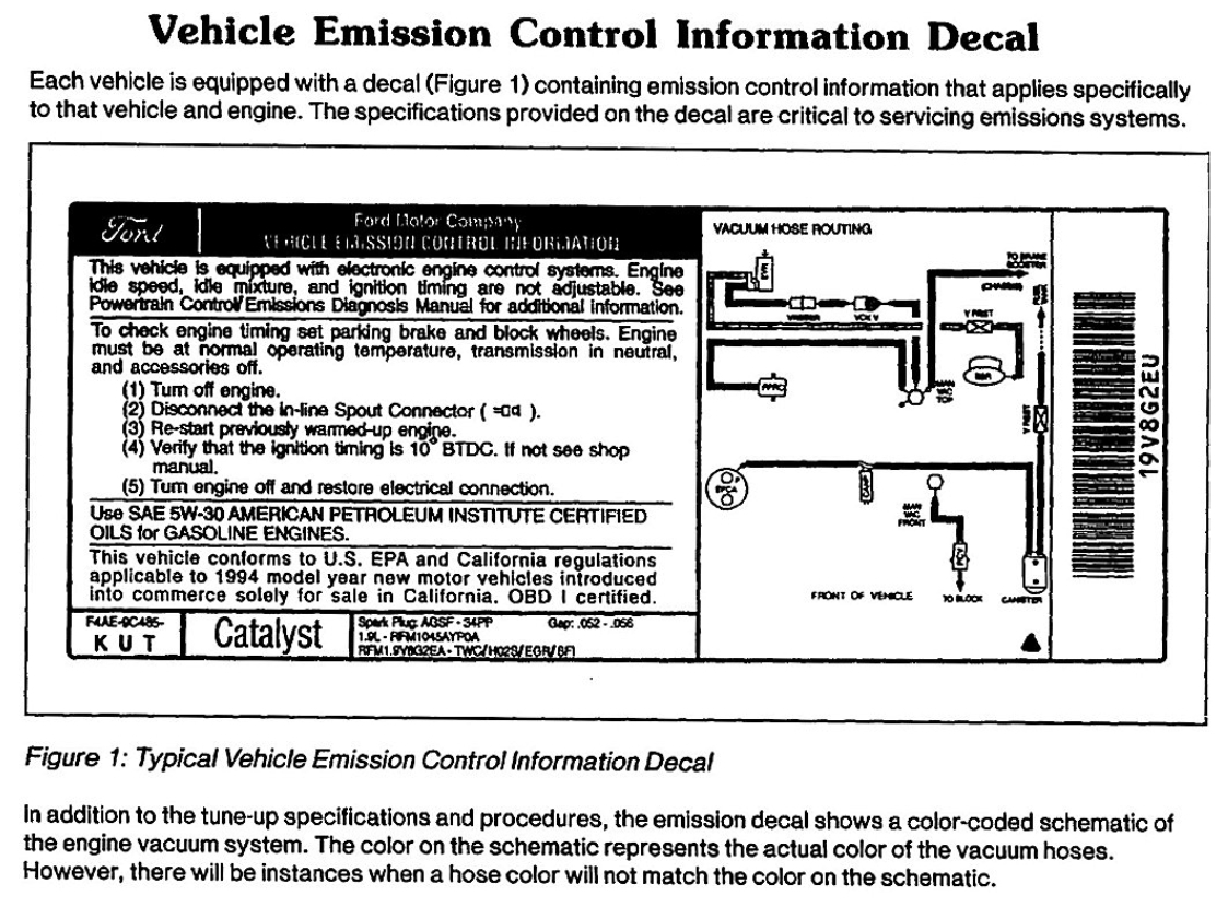

i have the truck listed above stock i want to change out the vacuum line's is there a diagram anywhere? i see the one under the hood but I'm just a little confused I'm unsure how to read it. It is color coded but the issue for me is some things have splits and so on. thanks, take care.
Jul 20, 2024 at 5:24 AM
  • 55,447 POSTS

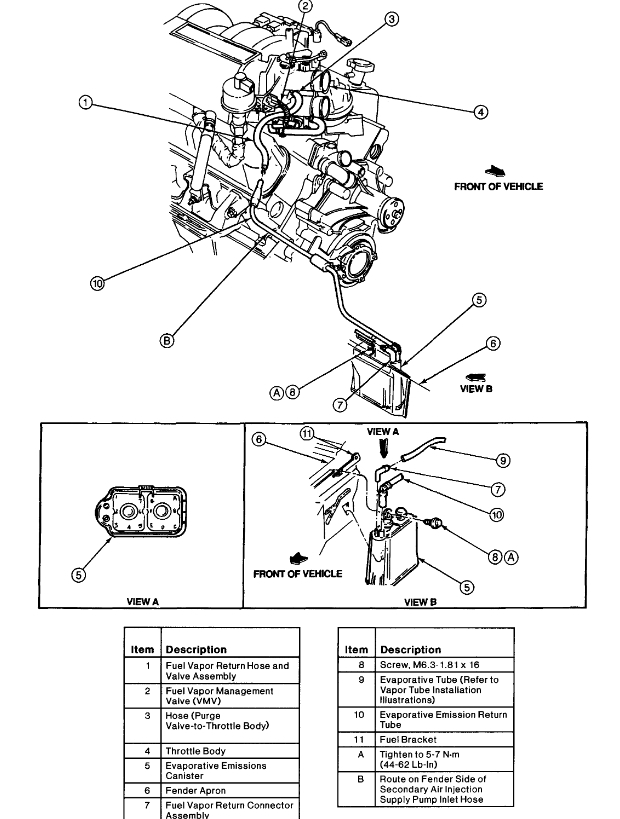

Sure, here are the engine vacuum line diagrams as you have requested. Check out the images (below). Let us know if you need anything else.
