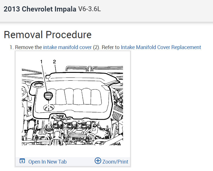

Yes, it will because it will fool the MAF sensor which will tell the PCM to give the engine less fuel. This guide can help you find the leak but only use this guide when the engine is cold. You can also use a smoke machine.

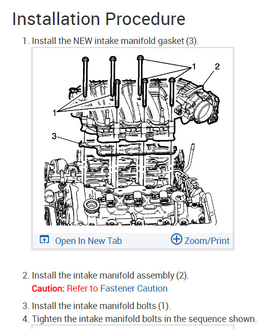

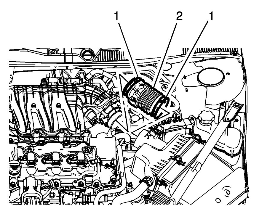

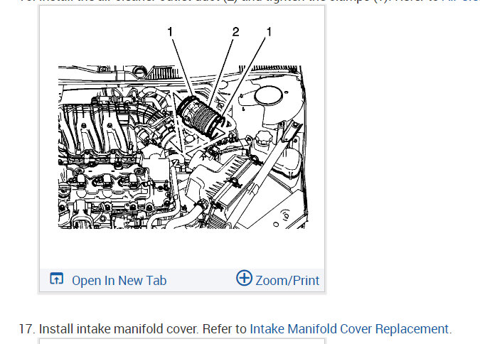

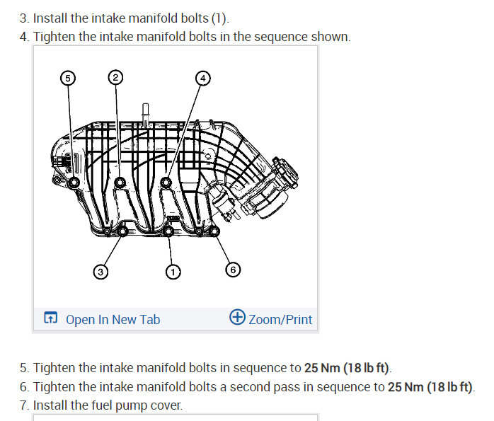

Also, I have seen the upper intake manifold plenum gasket give out which I have included how to change it out in case you find it leaking. Also, check the boot between the throttle body and MAF sensor. Check out the images (below). Please upload pictures or videos in your response to the problem so we can see what's going on.

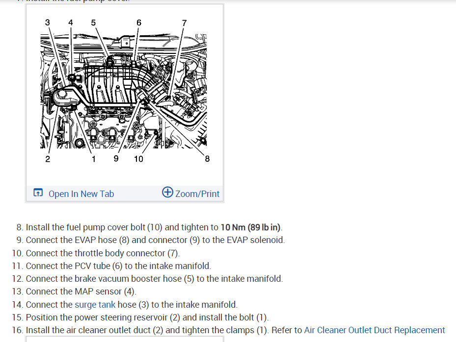

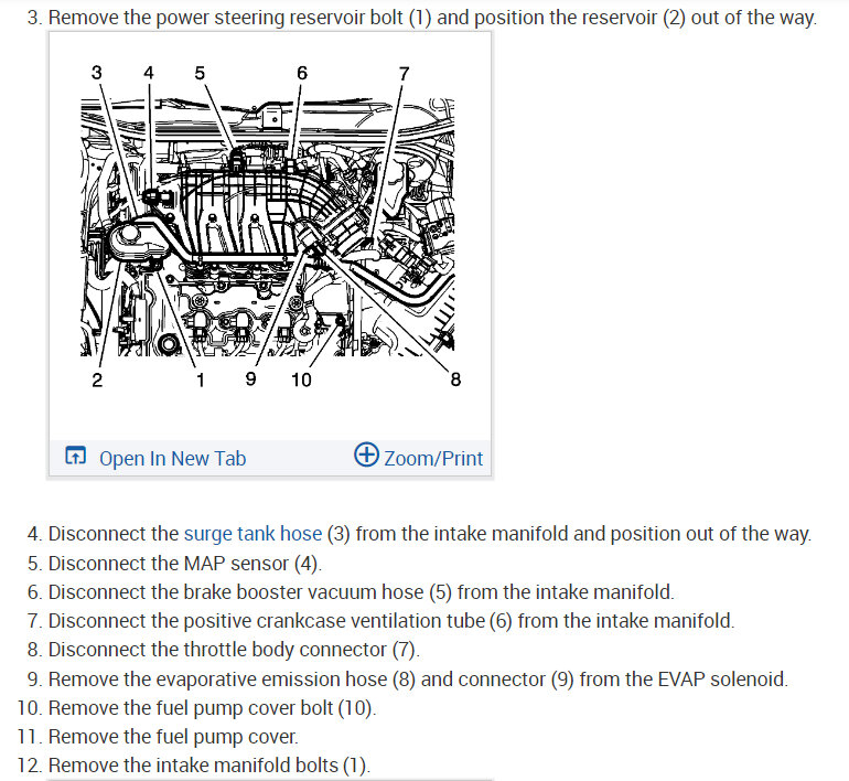

Okay, so I'm getting ready to tackle this finally. I'm going to do carb cleaner and vacuum pressure gauge. I have a few questions. The video is on a Camry. Can you show diagram where the intake manifold plenum, throttle bore gasket, evap control solenoids, brake booster this I assume is next to brake reservoir, MAP sensor and EGR valve located on the Impala? I'm going to go back over the diagram to change manifold gasket and see what's labeled there, thanks.

I found most in the intake manifold gasket replacement thanks.

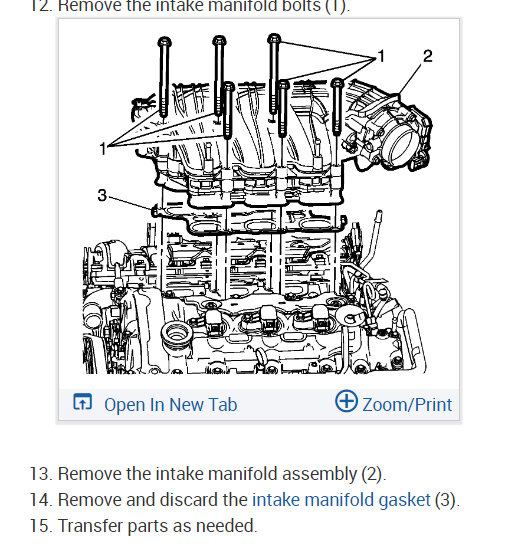

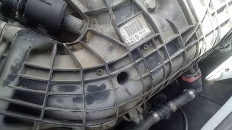

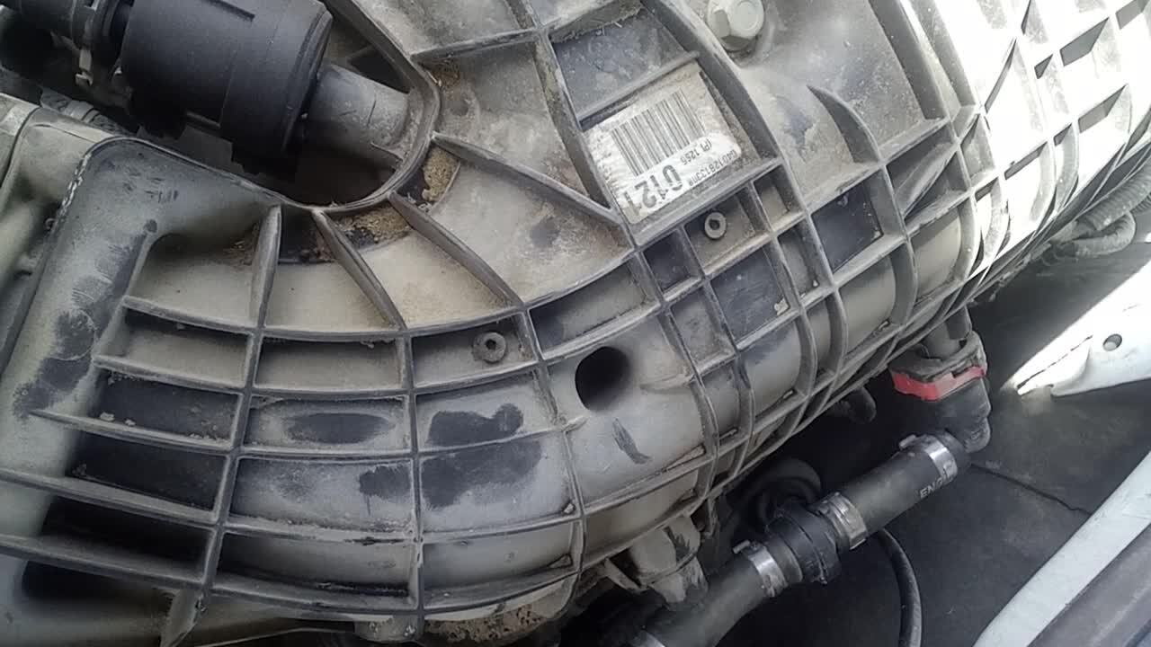

Alright, so here is a video of the engine running. Do you hear the vacuum leak? Also, where I think the manifold gasket is there is oil. I pointed it out in video. I'm sure that's a problem is that where mani gasket is? Thanks

Also, the second picture in the gasket replacement has no labels, just numbers and arrows. What is that thing called? I'm not up on terminology, sorry.

Okay, sprayed over the throttle body, evap control solenoid, which is new, all around the brake fluid assembly, MAP sensor no increase idle. I'm not sure where the EGR valve is, if I hit the brake booster or just sprayed everywhere, not sure where the throttle bore gasket is. It sounds like it's coming from under the intake manifold cover honestly.

Okay, so, the throttle bore gasket is that supposed to be throttle body gasket. Also, could you give diagram that shows where the parts are I asked about above? Thanks
Mar 12, 2024 at 5:11 AM
DAVENOOB
  • 371 POSTS
Brake booster I assume is under the brake fluid reservoir which side? What's the EGR valve?
Mar 12, 2024 at 5:12 AM
  • 55,433 POSTS
The brake booster is behind the brake master, but the hiss you hear can be a clogged catalytic converter which will account for the low power and poor engine performance.
