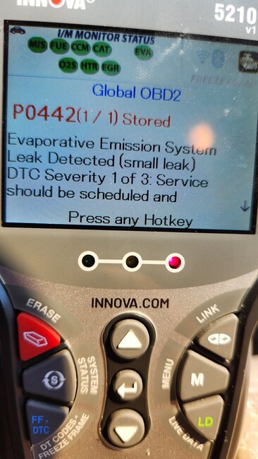

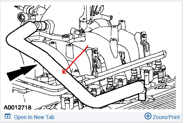

I keep getting a DTC for a small vacuum leak, but the truck seems to be running fine. Only place I have found a leak was in the A/C vacuum line that goes to the vacuum reservoir, and I repaired that. Is there any other common area where there is a vacuum leak or do you have a diagram of the vacuum lines? Thanks

Yes these engines had a problem with the PCV hose, you need to remove it to inspect. The hose falls apart internally. Here is a video to help find the leak as well, the machine is $65.00 on Amazon.

Check out the images (below). Let us know how it goes.

Okay. I will take a look at it. The DTC is P0442 by the way and this is what the scanner reads.

Okay, this is not an engine vacuum leak.
DTC P0442 - Evaporative Emission Control System Leak Detected (Small Leak)
So, I would check the gas cap O ring, this is a common place to leak. Next, check the EVAP lines from the engine to the fuel tank, and finally if you can find the leak use a smoke machine here is a video to help show you, I have seen the charcoal canister crack and give this code.
