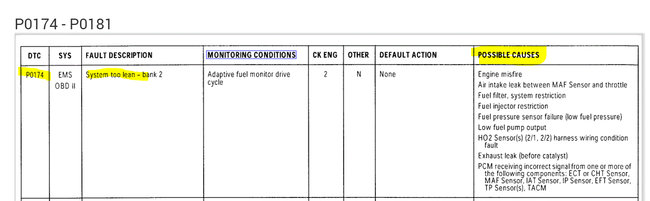

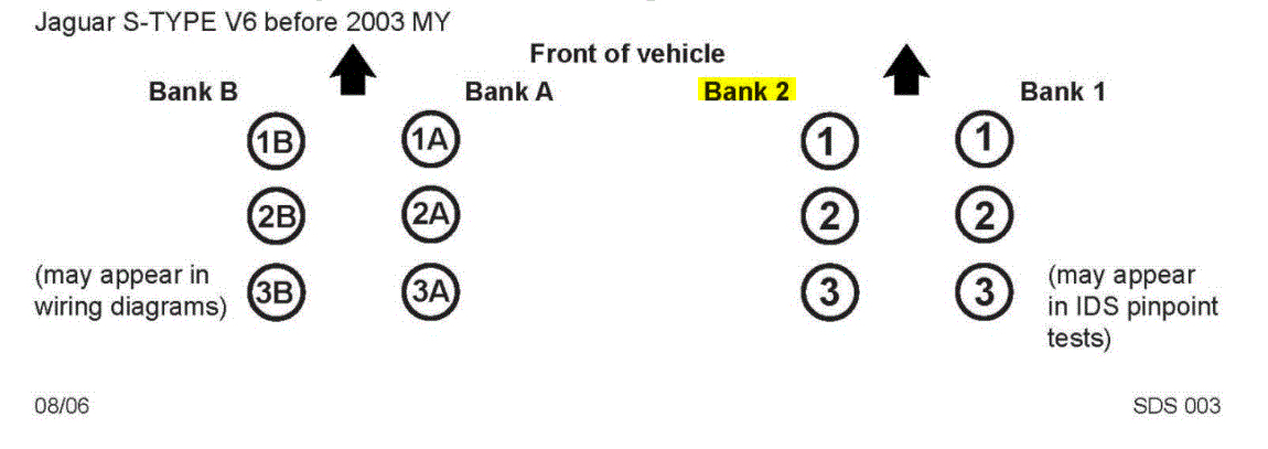

Code p0174, where is bank 2 located?

Have p0174 code need to know where bank 2 is and where the vacuum leak can be.

If you are standing in front of the vehicle with the hood open, bank two of the engine is in the right side. See pic 1 below.
As far as the code, when you only have one side of the engine with a lean mixture, it limits possibilities. See pic 2
By chance, do you have an exhaust leak on that side of the engine? Let me know. Also, here is a link that explains how to locate and fix a vacuum leak. Try this and let me know what you find.
