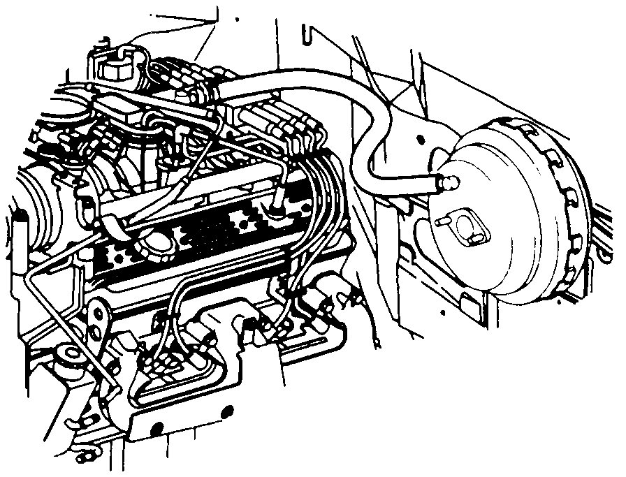

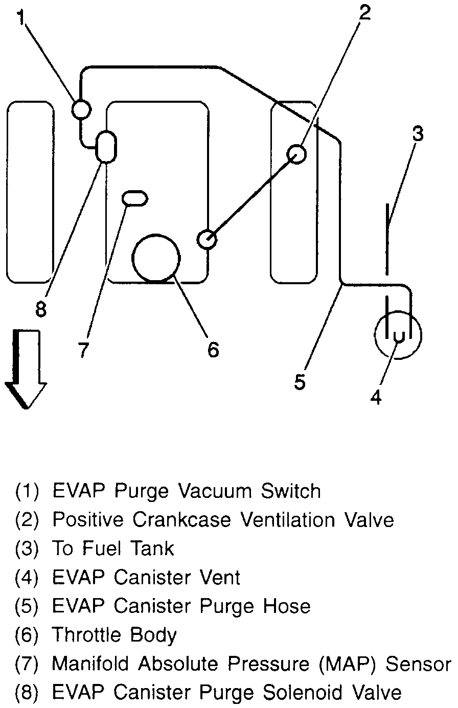

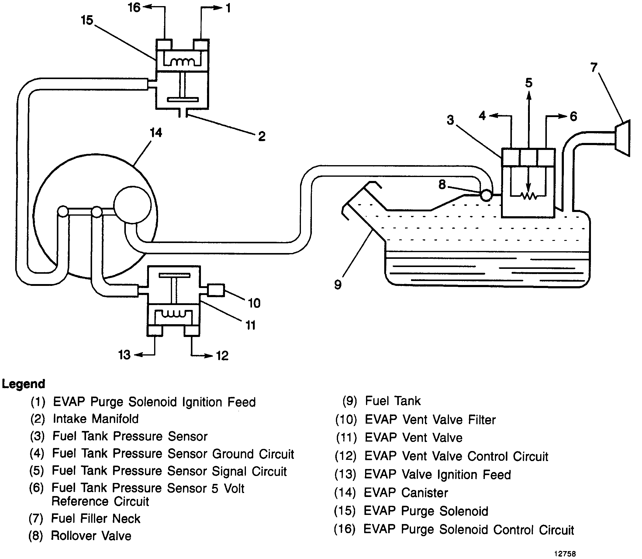

Is there a diagram for vacuum hoses for the vehicle listed above?
Feb 10, 2020 at 1:28 PM
  • CAR REPAIR CONTRIBUTOR
  • 110,190 POSTS
I attached the vacuum schematics for your vehicle below. If you are trying to find a vacuum leak, see if this link helps.
Let me know if this helps and what is happening.
