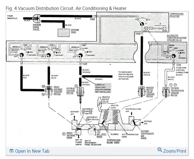

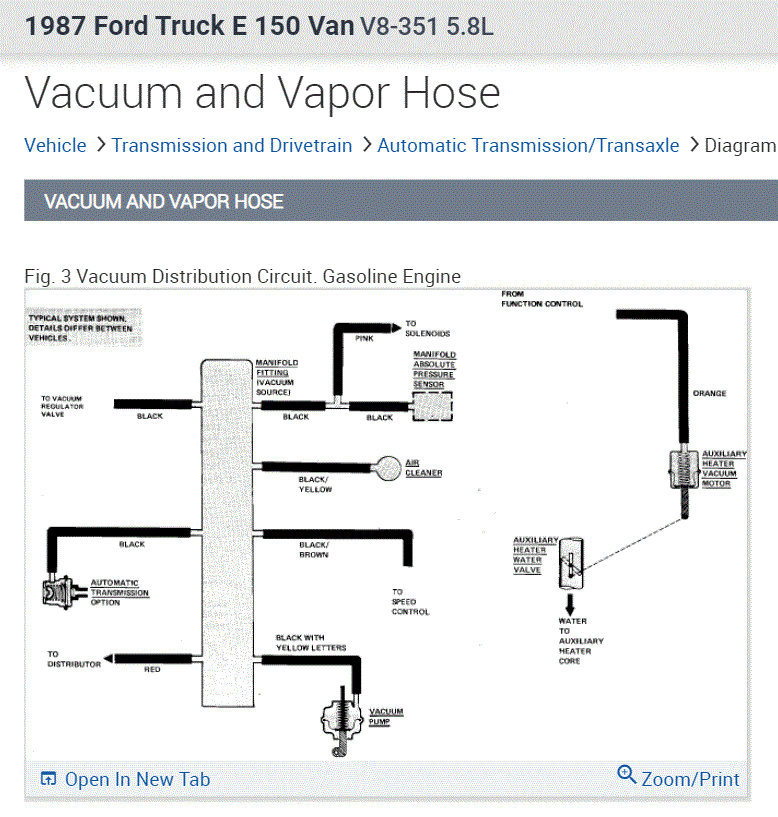

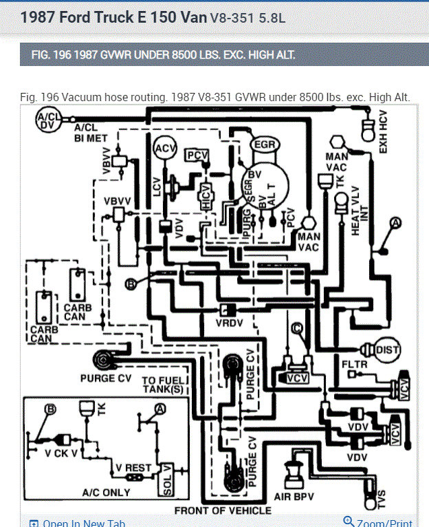

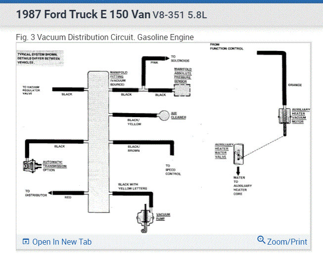

Can you provide a detailed layout (with pics if possible) for the vacuum route(s) of the aforementioned engine?

Because of the model year, the information is limited. However, I was able to find vacuum schematics for the vehicle. I have attached them below for you to review.
Let me know if there is something specific you are dealing with and hopefully, I'll be able to help guide you.
If you are looking for a vacuum leak, here is a link you may find helpful:
Pic 1 below is for the emissions system. Pics 2 and 3 are for the HVAC, and pic 4 is for the transmission.
