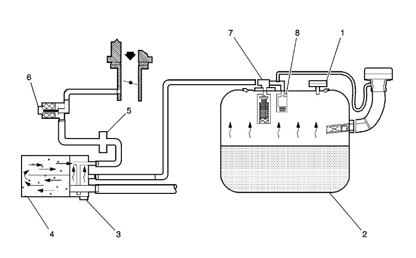

Can I get the vacuum hoses diagrams?
2007 SATURN SKY
147,000 MILES • 4 CYL • TURBO • 2WD • MANUAL
IANBRADY
I had to do repairs on my engine. To do the repairs I removed the vacuum hoses and can't remember how they go back on or where to route them. Please help me with a diagram or chart would be very appreciated. thank you
Sep 22, 2024 at 11:29 AM
  • 110,240 POSTS
I looked through my manual and I was only able to find the EVAP system schematics. If you look below, pic 1 is the schematic.

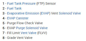

Picture 2 is the legend that identifies the different components in pic 1. Take a look through them and let me know if they help.
