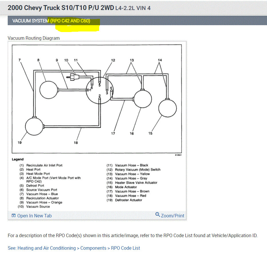

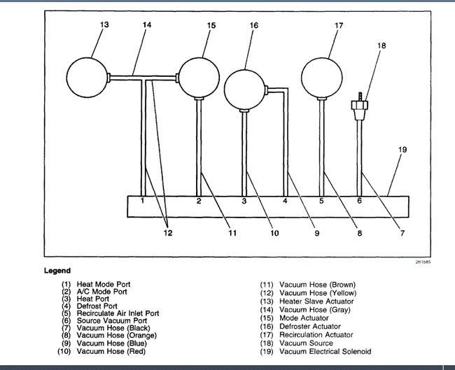

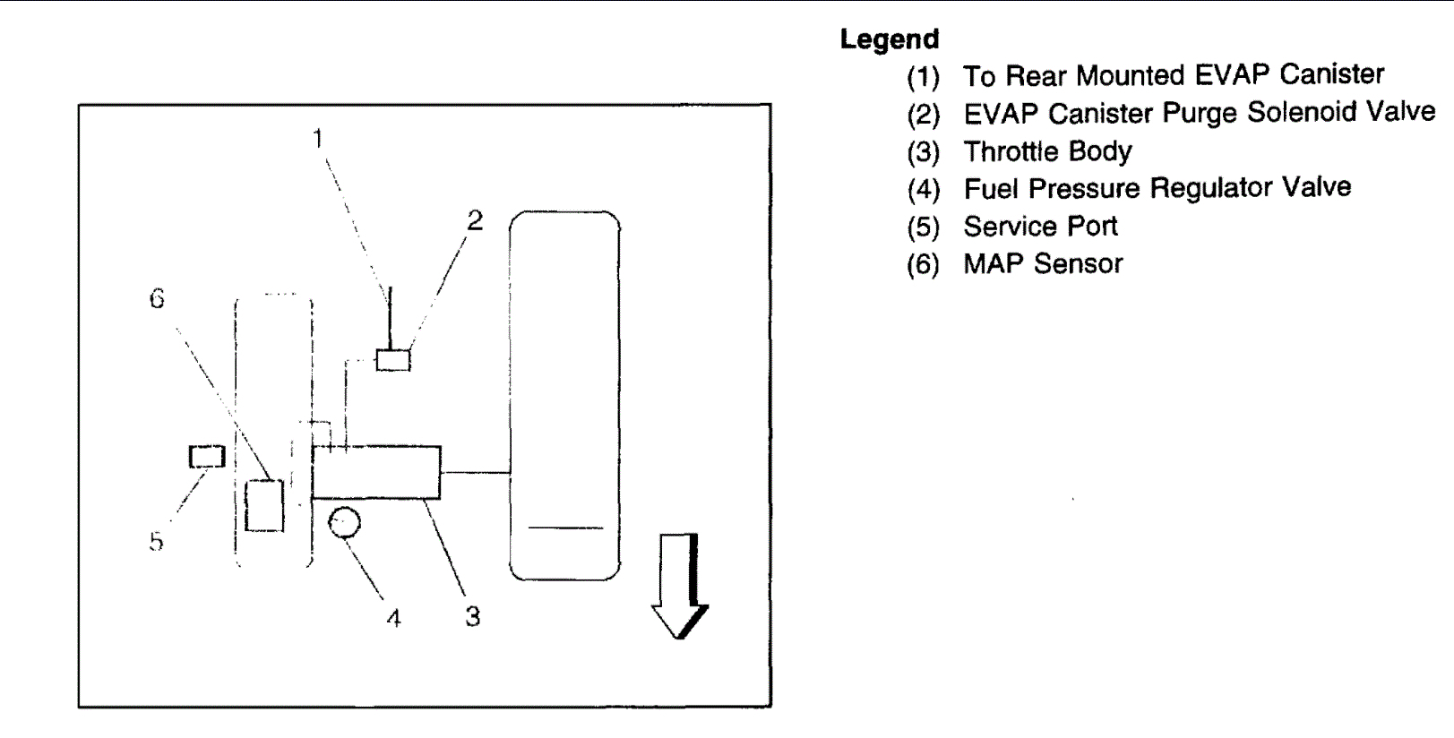

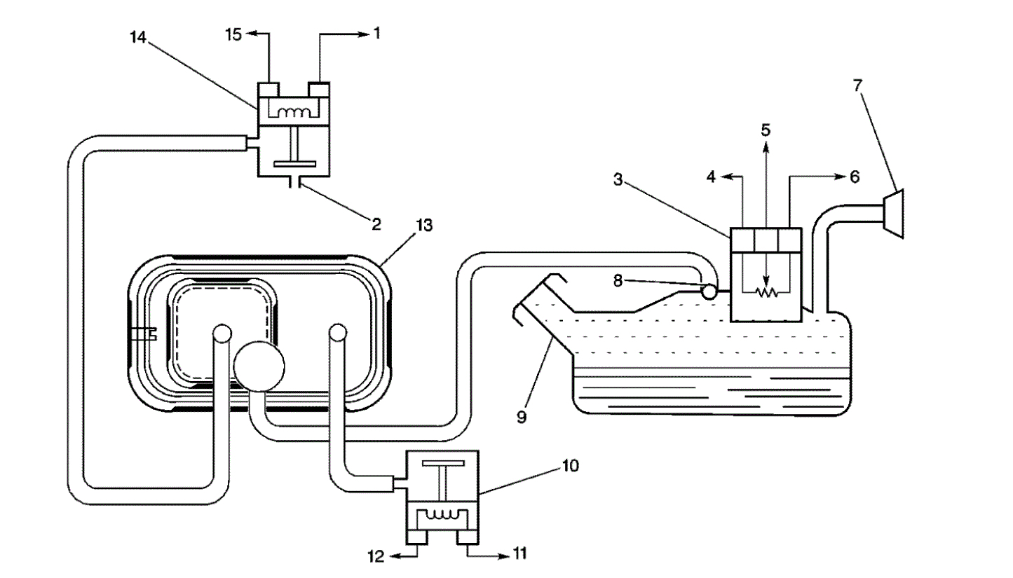

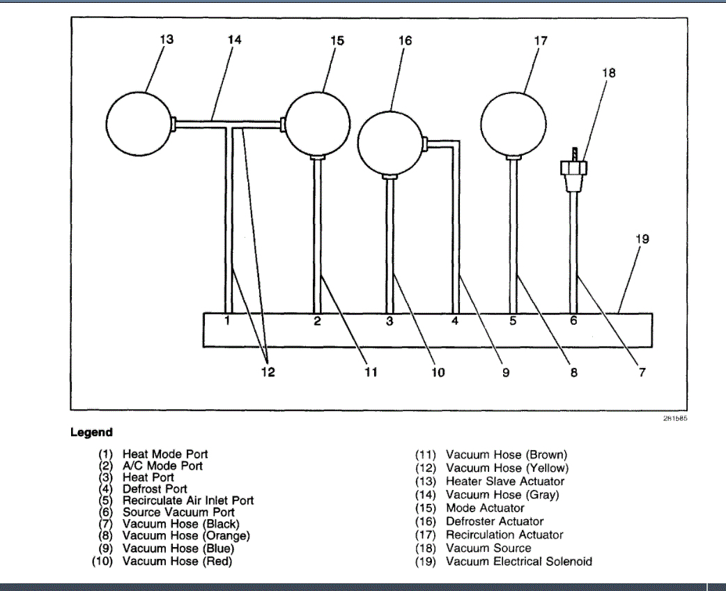

need to replace vacuum lines. need a diagram for them. especially heat control/select.
Aug 30, 2021 at 12:49 AM
  • 110,244 POSTS
If you look below, the first three pics are related to the engine/emission system vacuum system. Pic 3 is a legend of the components in pic 2.
As far as the HVAC, there are two possibilities based on RPO (regular production option). There is C60 which is for manual control heat/AC and C42 is automatic climate control.
The RPO can usually be found in the glove box. If it isn't there, check behind the driver's seat for a label.
