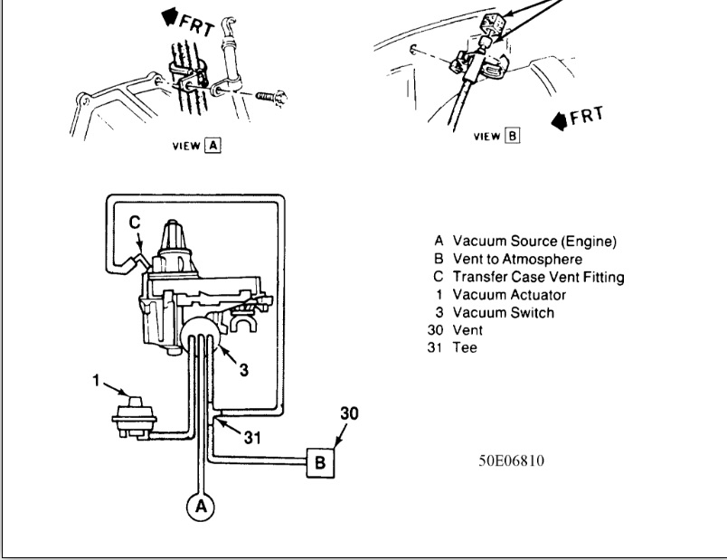

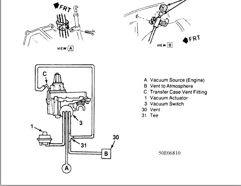

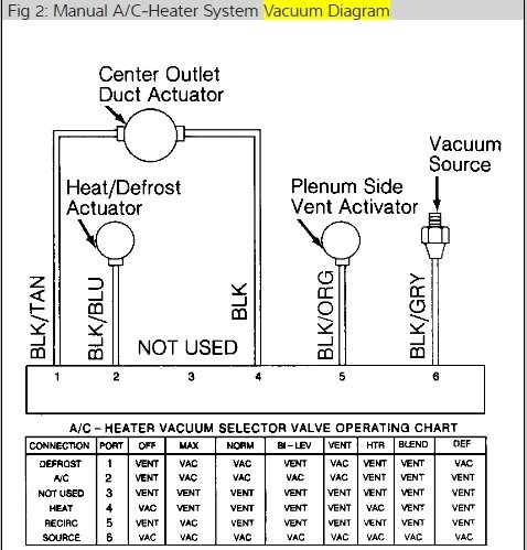

My vacuum lines got crossed when I had to replace fuel injectors. Now I hooked up my hoses, but the hose that comes from accumulator it says it goes to engine vacuum that is all it says. I looked in manual went on line I cannot find out were this certain hose goes. Please help.

I have a 1995 Chevy S10 2.2Liter 4 cylinder. I need to know were the the vacuum hose that comes from the accumalator. Were does vacuum hose go to? I know it goes on the vacuum harnest but were at? Thanks for your quick reply

This is what "Prodemand" had to offer
I had to make 3 screenshots to get it all
Lemme know if this helps
