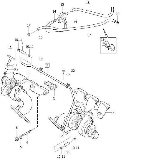

Can you get me a good picture of all the vacuum lines and where they go to? Thank you so much.

Layout of the vacuum lines to the turbos is in the image below
Parts 8, 9, 16, 17, and 18 are all vacuum hoses. The rest are hard lines.
17 will go to the charge pipe, 18 to just after the MAF, and 16 to the turbos.
Hope this helps.
Cheers, Boris
